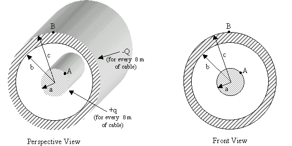

a is the radius of a cylinder that conducts everywhere inside it - it is a SOLID cylinder
b is the radius of the larger HOLLOW cylinder.
Might want to google coaxial cable to get a picture, your drawing doesn't look to convincing,
Does this help?
note that in your case b=c

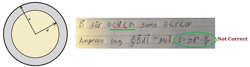

In order to find ##B## inside the inner conductor, you need to be able to find the total current inside a circular region of radius ##d##, where ##d \leq a##, as shown below. Can you think of a way to do this? You have to take into account that the current density ##j## varies with distance ##r## from the center.
Yeah, I know I didn't do correct at the places where you pointed out because the current must be constant, right? If the current density varies with distance then the area must also vary with distance because J(r) = I/A(r), is that not correct? The answer on your question is no, I cannot think of a way to find the current enclosed by a circular loop. How would you do it?
Thanks!

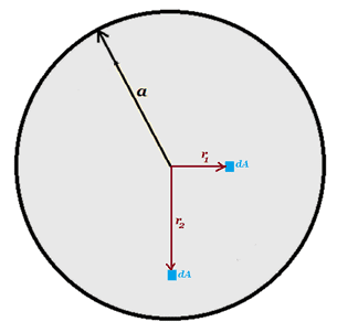

I'm not sure what you mean by saying that the current is constant. You are given a formula for the current density J = k/r. Here, r is a variable that represents distance from the center of the inner conductor. Suppose we consider two small patches of area, shown as blue squares below
Each patch has the same area dA. Which of the two patches has more current flowing through it?
How would you express mathematically the amount of current flowing through each patch?
Ooh, now I see. Whoever created this problem should have formulated differently and not written that current density decreases with distance. I thought they meant decreases with distance along the length of the cable but the meant along the radius. Now I get the correct answer. Thanks!
