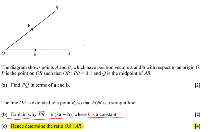

Determine the ratio ##OA:AR## in the vector problem
  • Thread starter Thread starter chwala
    Ratio Vector
The discussion focuses on determining the ratio OA:AR in a vector problem. An alternative method using simultaneous equations is presented, leading to the conclusion that OA:OR is 2:3, which translates to OA:AR being 2:1. The similarity of triangles POR and SOA is also mentioned as a supporting argument for this ratio. Participants emphasize the value of exploring different problem-solving approaches to enhance understanding. The conversation highlights the importance of collaboration in mathematical problem-solving.
chwala
2,827
415
see attached
Vectors
My question is on part (c) only.

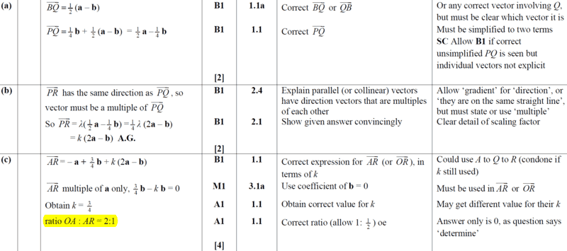

Find the markscheme solution below;
Mythoughts on this; (Alternative Method)
i used the simultaneous equation
##λ####\left[\dfrac {1}{2}a -\dfrac {1}{4}b\right]##=##\left[ -\dfrac {3}{4}b+ ka\right]## where ##OR=k OA##
##- \dfrac {1}{4}bλ##=## -\dfrac {3}{4}b## ⇒##λ=3## and also
## \dfrac {3}{2}a = ka## ⇒##k=1.5## therefore ##OA:OR=2:3## ⇒##OA:AR=2:1##
your thoughts guys...
Say middle point of OB is S, we know SA and PR are parallel. Similarity of triangles POR and SOA gives OA:AR=2:1.
Thanks Anutta...its always good to explore different ways in solving Math problems...by doing so i realize that i become better...cheers:cool:
