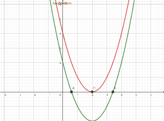

f'' is a second order polynomial. If it has two zeros then it crosses the line f'' = 0 at one zero, changes sign, turns around, comes back to the other zero, and changes sign again. If it only has one zero, then it just barely touches the f''=0 line, turns around without crossing it and stays on one side without changing sign. But the only way f'' can only have one zero is if ±√ is only one value. But that can only happen if it is ±0.
I still don't understand what do you mean by two zeros? The 0 of the square root and the f''=0 ? I am not able to visualize that in my head

This figure has two examples. The green parabola has two zeros at points A and B. The red parabola has 1 zero (actually a double zero at the same point) at point C. When the quadratic formula is used, the green line will give x values for zeros at A and B where ±√ is about ±1.5. The quadratic formula for the red line will give x=2 for a zero and ±√0. (In the red-line case, that is called a "double zero" at x=2.)

±This figure has two examples. The green parabola has two zeros at points A and B. The red parabola has 1 zero (actually a double zero at the same point) at point C. When the quadratic formula is used, the green line will give x values for zeros at A and B where ±√ is about ±1.5. The quadratic formula for the red line will give x=2 for a zero and ±√0.
Sorry but I don't understand why It works if the square root is 0, what's left in the x doesn't matter?: $$\frac{-4-a}{2}$$
The whole x shouldn't be equal to 0?

Now consider FC's graphs in Post # 6 .
Yes but why the sign doesn't change if the square root is equal to 0 but works with any other result of the square root?

Because, in that case the quadratic function has only one zero (x-intercept).
If the quadratic function has only one zero, then it doesn't change sign. See the red graph in post #6. Study @FactChecker 's explanation again and again.

That part certainly does matter. If ±√ = ±0, It tells you where the double zero is located. Otherwise, there are two different zeros and it tells you where the midpoint of the two zeros are.
But it doesn't change the important aspect that you are concerned about -- if the sign of f'' changes. That is just determined by ±√.
So because $$f ''(x) $$ is a quadratic polynomial the x must have two solutions (greater than 0) in order to have inflection points?
Exactly. -- The √ must be > 0 so that ±√ forces two different zeros.
