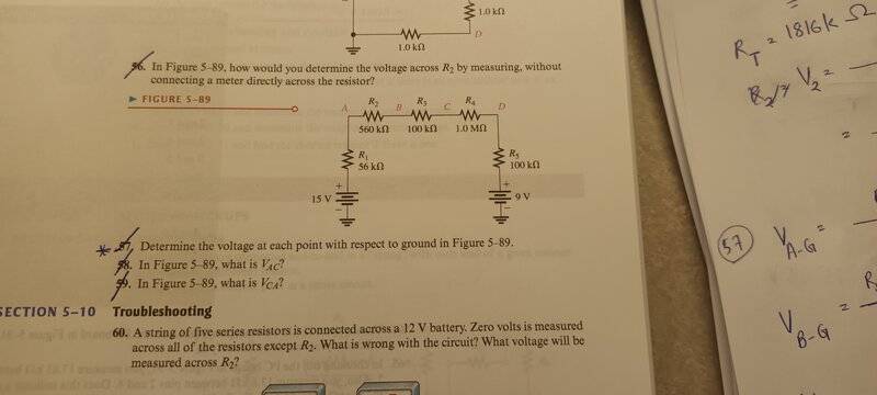

Determine the voltage at each point with respect to ground in the figure provided.
V=I/R, V(drop)=Rx/Rt * Vs
This is the figure stated for problem 57.

Yes, you have stated what the question is asking YOU. What is needed is, what are you asking US?
The figure in your drawing is not the same as in the book image. It is not even clear what problem are you asking about.
The first photo is just my attempt showing that I have tried. The probem number 57 is what I am asking about. Sorry for your confusion.

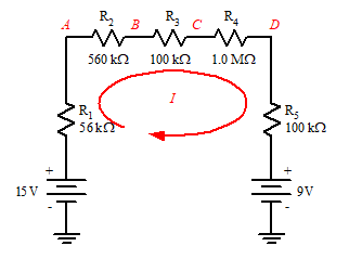

@Lay1 combined the two sources into one, so the image in the picture is okay, it just didn't mention the additional step.
One way to do this problem is to first work out the total current and then use KVL around the loop, adding in the successive resistors as you go. For example, finding the voltage at point C you could start at the negative terminal of the 15 V battery and work your way around the loop clockwise until reaching point C.
##V_C = 15 V - (56 kΩ + 560 kΩ + 100 kΩ) ~ I ##

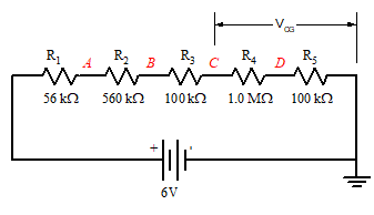

Sorry, but I can't quite make out your figures in the image provided. I believe that you're trying to form the partial resistance over the total resistance for each of the points A,B,C,D? For example:
If the total voltage is ##6 V##, and ##R_T## is the total resistance, then the voltage at ##C## with respect to ground will be:
$$V_{CG} = \frac{R_4 + R_5}{R_T} 6 V$$
If that's so, then we'll need to see a better image of your work to find the error.

You can reduce the book schematic to a very simple form by using a well known property of resistors in series.

First, let's name the other nodes in the original schematic (the one with 2 batteries). So "E" is between R5 and the 9V battery. "F" is between R1 and the 15V battery.
V(A)=(R2+R3+R4+R5)/Rt *6V is what I would call VAE, the voltage across R2, R3, R4, and R5; or the voltage from node A to node E. They want the voltage at node A with respect to ground, not with respect to node E. Voltmeters always have two probes. For convenience in communication we assign (sometimes a bit arbitrarily) one node in the circuit to be "ground" and all voltages that are expressed as the voltage at node "X" are assumed to have the other (-) voltmeter probe at the predefined ground location.
Your problem is to find the voltage at node A, B, ...etc. with respect to ground; meaning that the - meter lead is at ground. What if there was no ground symbol. What if we just called that node "G". Could you find the voltage from node A wrt node G. This is essentially the same as problem 58. Find the voltages between two nodes, one of which is between the two batteries in this case.
BTW: anyone that is using your simplified schematic with only one battery isn't helping. It's problem #57 people! They probably haven't really read the problem in question. Best to ignore them and focus on my previous comment about redefining "ground".
