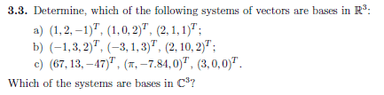

Please see the attached picture
Reduced echelon form of the column matrix
I can solve for the first part to find which ones are the bases in ##\mathbb{R}^3## by determining whether in the echelon form, there is a pivot in each column and row. But what about ##\mathbb{C}^3##? Since a general vector in this space takes the form ##(a+ib,c+id,e+if)^T##, if there is no imaginary number in the vector, which is the case in all those three sets of vectors in the problem, then they cannot span ##\mathbb{C}^3##?

What would be an example basis for ##\mathbb{C}^3##?
##(1,0,0)^T##, ##(i,0,0)^T##, ##(0,1,0)^T##, ##(0,i,0)^T##, ##(0,0,1)^T##, and ##(0,0,i)^T##, no?
Are those linearly independent?

Take it to be a complex vector space. Now, are those vectors you gave linearly independent?
On a second thought, they are not, because for instance ##(i,0,0)^T=i(1,0,0)^T##.
So, this means the standard basis for ##\mathbb{R}^3##: ##(1,0,0)^T##, ##(0,1,0)^T##, and ##(0,0,1)^T## can also be a basis in ##\mathbb{C}^3##?

It does indeed!
This means in the original problem, any bases for ##\mathbb{R}^3## are also bases in ##\mathbb{C}^3##?
Can you prove that? It's not hard.

Be careful. ##\mathbb{R}^3## is a real vector space, that is a vector space over the field of real numbers. But, the subset of ##\mathbb{C}^3## represented by vectors of the form ##(x_1, x_2, x_3)## is not a subspace. It's not closed under (complex) scalar multiplication.
Ok I get it, ##\mathbb{R}^3## is not a subspace of ##\mathbb{C}^3##, but a subset.
Then to answer my question in post #9, any bases of ##\mathbb{R}^3## in matrix form can also be bases in ##\mathbb{C}^3##, but the converse is not true.
Yes, although I think this is where you need to be more precise with your terminology. Viewing ##\mathbb{R}^3## as interchangeable with the subset of ##\mathbb{C}^3## consisting of real-valued vectors can lead to problems. Instead, to be precise:
1) Any basis in ##\mathbb{R}^3## when mapped to the equivalent vectors in ##\mathbb{C}^3## forms a basis for ##\mathbb{C}^3##.
2) There is not necessarily a direct mapping from a basis in ##\mathbb{C}^3## to vectors in ##\mathbb{R}^3##.
Remember also that ##\mathbb{R}^3## is a real vector space (over the field of real scalars) and ##\mathbb{C}^3## is a complex vector space (over the field of complex scalars). This means that you have to be careful not to link the two together too closely. In general, you cannot look at a real vector space as a subspace of a complex vector space, because the field of scalars is different.

Alright then, by computing the echelon form and analyzing the existence of pivots in each column and each row in the original problem in post #1, I found that the system of vectors a) and c) form a basis in ##\mathbb{R}^3##. Then, basing my argument on
PeroK said:
1) Any basis in R3\mathbb{R}^3 when mapped to the equivalent vectors in C3\mathbb{C}^3 forms a basis for C3\mathbb{C}^3.
these systems of vectors are also bases in ##\mathbb{C}^3##?
maNoFchangE said:
I guess that bolded part is the key point.
Yes.
