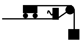

I have an extended system consisting of a track, a spring, a spring attached to a moving cart on one end, a string attached to the other end of the cart, and a hanging object attached to the end of the string. I need to find one equation that allows me to measure the total frequency distribution of the system. In my body diagram, I found forces of kx for the force of the spring, the tension of the string on cart in the +x direction and as a force on the hanging object in the +y direction. Finally, a force of mg on the hanging object's wieght. From doing the experiment, the frequency was found by measuring the oscillations of the spring in completing a period as a total time was taken for it to complete its cycle. I'm not sure how to find the final equation for the freqency.

I'm not totally certain I understand what the experiment looks like. I have attached my own drawing of what I think the experiment looks like (where the little squiggle is a spring).
From looking at your equations for forces of system, you need to specify which object you are talking about. There is the hanging object and the cart, each will have its own body diagram, so you should write out both of these, then think of a way of relating the two equations.

Your diagram shows the correct setup for the experiment, thanks for drawing that out! And when I showed my total systems of equation formula, that is how I tried to show how the cart/spring relate to the hanging object:
Total forces of system: mg-kx=ma
For this experiment, we had to determine the impact of mass on the number of osillations of the spring. For one set of trials, the mass of the hanging object was adjusted and the mass of the cart was constant. as the number of times that the spring attached to the cart would oscilliate and timing how long it took for it complete one cycle. For a second set of trials, the mass of the hanging object was kept constant as the mass of the cart was adjust and the the number of times that the spring would oscillate was recorded again and in timing it again for how it took to complete a cycle.
I'm not sure from here how to come up with a single equation that shows how to find a predicted frequency to the forces equation shown above. In my previous post, I showed what each formula in simple harmonics to a spring correlates to in finding angular frequency, frequency, and period but I'm not sure how to set it up to one equation.

This equation is almost right, but the m on the left hand side and the m on the right hand side should different things. When you were calculating the forces, you wrote T=mg, but this is not correct, because the hanging mass will also undergo oscillations.
Remember that you have 1 equation for the vertical motion of the hanging block and 1 equation for the horizontal motion of the cart. So you need to use different values for m in each equation.

Violagirl said:
Before, I was thinking that T could become mg so it could be substituted into the x equation to make it into one equation.
No, T won't be equal to Mhg (Mh being mass of hanging object), since that object accelerates.
You can either do the standard thing of treating each mass separately, connected by equal and opposite T and a:
T-kx=Mcax
T-Mhg=Mhay
ay = -ax
or finesse it by taking the sum of the masses as the inertial mass but Mh as the gravitational mass.
In going back to look it, I found that it would make sense to take the sum of the masses in having an impact on the frequency of the spring. So therefore, I found that:
f=2ττ√mcart+massweight/k
I'm not sure what to do with the +y direction though in correlation to the +x or to Newton's second law...
The nice thing about this problem is that if you didn't realize that the effective inertial mass is equal to the sum of the masses, then you could use Newton's laws to solve this problem, and you would find out that the effective inertial mass is equal to the sum of the masses.
Since you have already realized that the effective inertial mass is equal to the sum of the masses, you don't need to do any of Newton's laws. (unless your teacher is expecting you to show why the effective inertial mass is equal to the sum of the masses).
p.s. I think you missed out a 1/ in your equation for f
