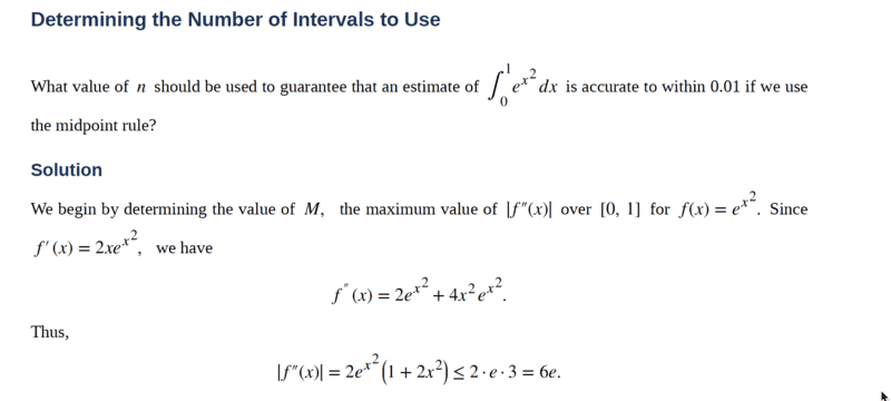

My question is two fold:
First, why is ##M## the absolute value of f''(x)? What is the role that the second derivative plays here and why absolute value?
Second, please see the attached image which is part of an example problem in my text. I don't know what they're doing when solving for the absolute value of f''(x). Clearly, the maximum would be 6e, as when we plug in 1 into the second derivative, this is what we get. But I don't know what they're doing to get this value. I am referring to the very bottom line of the attached image.

I think they choose ##x = 1## because that will give the largest value for ##f''## by inspection.

Google is your friend. Do a search using keywords "trapezoidal rule error", and you will find articles that tell you all you want to know, and more.
Anyway, I do not agree with their calculation leading to ##|f''(x)| \leq 6##; I would say that ##|f''(x)| \leq 18,## because ##2 \times 3 \times e \leq 18.## So, I think you need to take ##M = 18## (or ##M = 6 e,## which is a bit less but harder to use and probably will not affect ##n## very much).

So to find the error of approximation with a problem like this, we need to graph it and see where in the interval that the second derivative is the largest (most concavity)? And this is where I have been confused in my research- we are using the trapezoids to "fill up" the area under neath the graph of ##f## Now depending on concavity of the graph of ##f##, that will determine if the approximation is an over estimate or under estimate in that interval. So why don't we just look at the graph of ##f## rather than the graph of ##f''##? Or do we look at the graph of ##f##, we are just concerned about ##f''## which is the concavity of ##f##?
So then our errors are naturally going to be different for the intervals that we choose and depending on the interval, we can have either an under approximation or an over approximation?
I've done the research but can't find an answer as to why we have an absolute value here.
The Wikipedia entry proves the formula
$$\text{error} = f''(\xi) \frac{(b-a)^3}{12 N^2}, $$
where ##f''(\xi) = \max_{x \in [a,b]} |f''(x)|.##
The article suppose the error measure to be ##> 0## because it measures an upper bound on the distance between the computed result and the true result. If you look more carefully into the proof you will realize that if
$$ m_1 = \min_{x \in [a,b]} f''(x) < 0$$ and $$m_2 = \max_{x \in [a,b]} f''(x) > 0$$ then the actual numerical error (positive or negative) satisfies
$$ m_1 (b-a)^3/(12 N^2 ) \leq \text{numerical error} \leq m_2 (b-a)^3/(12 N^2)$$ Therefore,
$$\text{error} \equiv |\text{numerical error}| \leq \max(|m_1|,|m_2|) (b-a)^3/(12N^2)\\ = \max_{x \in[a,b]} |f''(x)| (b-a)^3/(12 N^2)$$
Likes opus
Ok thanks so much Ray, the key word distance there makes sense to me intuitively, but i went through that proof and its over my head currently. I just started Calculus 2 so the notation and techniques there were foreign and I didnt know what to even Google to clear up my confusion in the proof.
