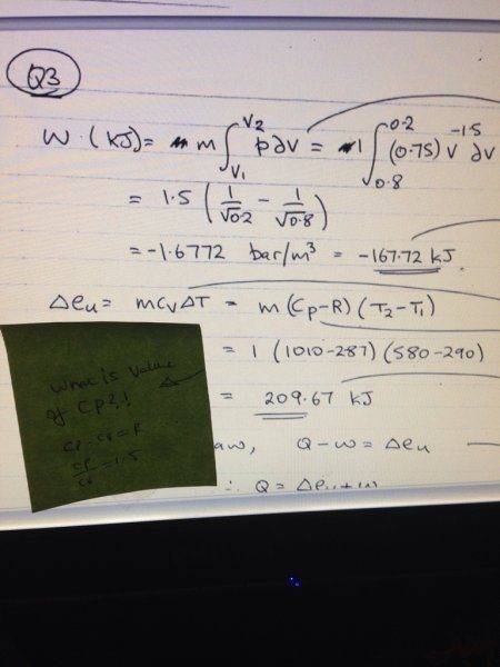

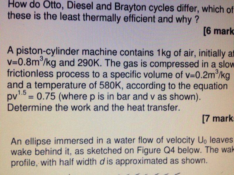

Stuck on part of this question regarding Cv value:
I don't understand how one can get the value for Cv,
I tried saying Cp - Cv = R (1)
Cp/Cv = 1.5.so rearrange gives Cp=1.5Cv (2)
Now sub 2 into 1 and that gives 0.5Cv = R
But according to solutions that's wrong, Cv is 1010 and I can't get that value!
Please point me in the right direction,
Kind regards ,
Jay

I see, if R has value 287, then Cv is 717.5 - still not the value used according the solutions which is 1010
Jay

My mistake and confusion - sorry!
I want to start again to make it clear for myself:
In the solutions he uses Cp - R rather than Cv, why? We could have just used value for Cv like you said equal to 2.5R
Ignoring above and continuing like the solutions, how is Cp value obtained? Eg you said it for Cv, what about Cp ? I guess we could times Cv by 1.5 but that defeats the purpose of using Cp - R when we already knew the value of Cv!
(When I try your way of using Cv, the final answer varies slightly)
