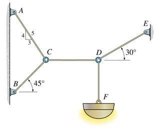

Determine the maximum mass of the lamp that the cord system can support so that no single cord develops a tension exceeding 350 N
F(x)=0; F(ED)cos30 - F(CD)= 0
F(y)=0; F(ED)sin30 - W
F(ED)= 2W
F(CD)= 1.73205W
F(X)=0; 1.73205W - F(AC)(3/5) - F(CD)cos45 = 0
F(y)=0; F(AC)(4/5) - F(BC)sin45 = 0
F(AC)= F(BC).88388
This is where I start getting confused. With all the substitutions.
This is incorrect. Check your FBD and make sure you're writing out your equation with the correct subscripts.
From the lower fbd:
F(x)= 0; 1.73205W - F(AC)(3/5) - F(BC)cos45
Robb said:
From the lower fbd:
Alright, so substitute in for F(AC) in this equation. Use this to write F(BC) in terms of W. Afterwards you can then write F(AC) in terms of W. You will then have expressions for all the forces of tension in the ropes in terms of W. Comparing all of these you should be able to determine which rope develops the maximum tension in this system.
Also, as a quick alternative to going through all the math: Examine each FBD carefully. Assuming static equilibrium of the ring at point D, it can be said that F(DE) must be larger in magnitude than F(CD) since only one component of F(DE) balances the force F(CD). A slightly more careful consideration of how this strategy applies to the FBD of point C should lead you to find which rope is under the maximum tension. As you can see, most of the trouble in this problem is finding that particular rope.
So, F(AC) = .88388F(BC)
1.73205W - F(BC).53033 - F(BC).7071 = 0
-1.23743F(BC) + 1.73205W
F(BC) = 1.39971W
F(AC) = 1.23718W
W = 150
The answer is 17.8? Not sure how to get there.
I like the insight. Now that you mention it it looks obvious.
F(BC) = 1.39971W
F(AC) = 1.23718W
W = 150
See edit to W.
Ok. I got it. Sorry. Thanks for your help!
Robb said:
W = 150
No problem. Just one last thing.
Not sure if your edit on your post for the value of W worked. Just to clarify it should be 175 N. Although I will assume that you must have gotten that result if you calculated 17.8 kg as the mass.
