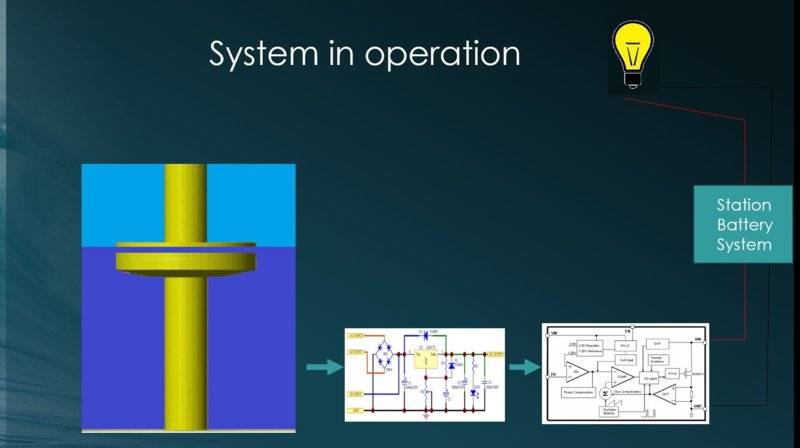

No spin, only vertical movement across coil images not to scale of course,
Where does that diagram in post #3 come from?
Likes BabyHueyTAW and jim hardy

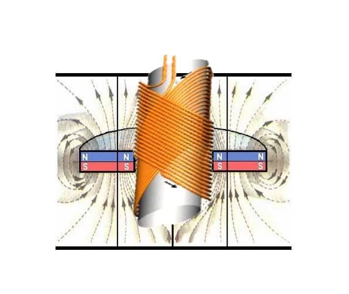

1. Volts is product of (rate of change of flux that's encircled by your turns) X (number of turns)
Flux is product of flux density(that's your Gausses) X area , adjusted for the geometry
How many of those 13,800 Gausses go down through your coil where they're encircled by your wires ?
And how fast does the magnet move?
2. Viewed from the top
your outer coil is wound clockwise
your inner coil is wound counterclockwise
so any voltage induced in one coil will cancel voltage induced in the other.
That the coil diameters differ by one wire thickness means they have unequal areas so the voltages won't exactly cancel,
but i think that machine is going to disappoint you.

A weird idea. It would be nice to have a link to the theory. Without that I question the orientation of the magnets and the lack of a better defined magnetic path. As it is there will be significant cancellation.
If half the diagonal winding was not reversed there would be no reversal of flux between the ends of the movement where the coils do not overlay. As it is, a current sheet flows down the near side of the coil and up the back, but it is linear, not rotating. We will have to wait for further information.
This is something I cobbled together with MS Paint. trying to explain what I want to do.

Baluncore said:
Yes, a candidate for DIY.
As far as the lay of the coils in the image, those are really just a visual for the idea in my head. I did not consider the cancellation. I think I may actually have better results trying this the old fashioned way of trial and error. I will repost over in DIY. Thank y'all!

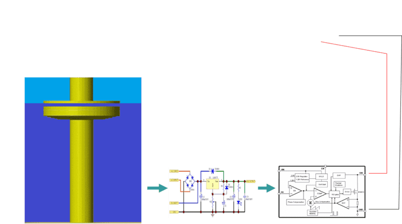

As the magnet in the large disc move up and down the column which houses the coil. If this helps explain better
Looks like energy extraction from water wave motion? I don't think your magnet/coil geometry is optimized for that energy source. Have you looked at how existing wave energy conversion mechanisms work?
This is exactly the concept, just want to move the magnet not the coil

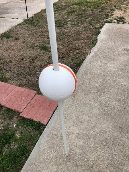

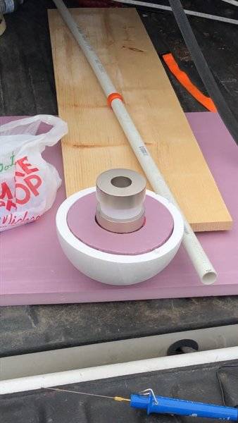

Inside the PVC I will have a wooden dowel, wrapped around the dowel is my coil. the magnet stack will be free moving vertical only.

That's clever construction there...

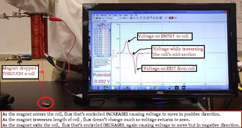

I mentioned up above 'rate of change of flux that's encircled..'
Encirled flux will only change near the top and bottom of your coil
here's a demonstration of that , at www.youtube.com/watch?v=jaZfTXUv_lI
which means bouncing a short magnet up and down about the middle of a tall coil won't do much in the way of generating electricity.
But you can experiment with varying ratios of magnet/coil tallness to find a combination that'll work.
Likes berkeman and BabyHueyTAW

Hmm, so my coil does not necessarily need to be that tall as long as my magnetic field cuts both ends. I think I understand. I think my wife would shoot me if i bought a copper pipe right now just to play with. she was not thrilled with the price of my toy magnets...

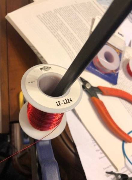

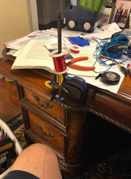

I will keep playing with this more. I have 800 feet of 32awg magnet wire and 2pounds of 24 awg to play with my 3/8" OD wooden dowel, will post pictures and thoughts as I go. I really appreciate the thoughts and support as I tackle this.

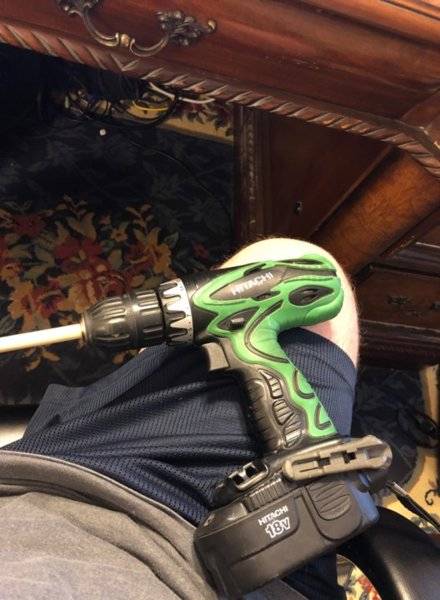

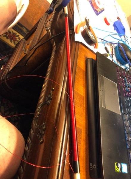

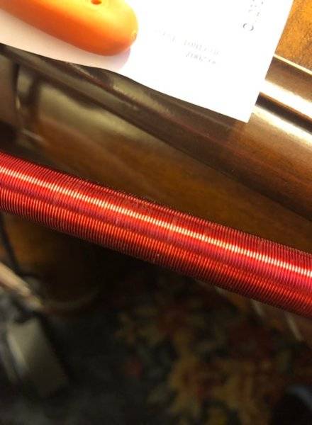

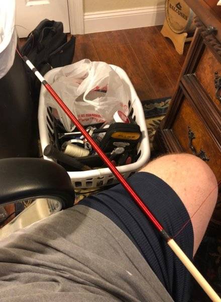

So I am going to try this, and see what we see.

jim hardy said:
Are you above "Dumpster Diving" ? Perhaps a piece of shower curtain rod ...
aluminum tubing is pretty common stuff.
Never above diving!
! I Now Understand what you mean on the enter and exit voltage! My coil is much too long and not enough coils to cut with the magnetic field! I must shorten my coil and add layers to it! You guys are amazing!
