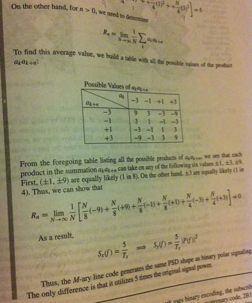

Ok So this is an example from my text. I am having trouble following a portion of it and was curious if anyone could shed some light on it. I've typed most of it and posted a screen shot of the second portion since there is a table involved.

Here is the second portion:
I understand how to calculate ##R_0## from this example. I get lost when the text calculated R_n. I see how they created the table of all possible values for ##a_k*a_k+n## but when the ##R_n## equation is put together i get confused.
In the paragraph below it they attempt to explain. Why are ±1 and ±9 equally likely (1 in 8) and ±1 are equally likely (1 in 4). I would have expected them to be the other way around.
Can anyone shed some light or offer a better explanation?

The table contains 16 entries. Each is equally likely.
The value 1 appears twice in the table, so the corresponding probability is ##\frac{2}{16}=\frac{1}{8}##.
However, the value 3 appears four times in the table, so its probability is ##\frac{4}{16}=\frac{1}{4}##.
Simple! Man I really should have seen that.
Anyway thanks again for your help ILS!
