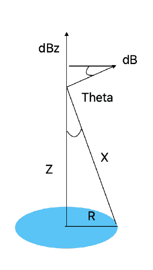

A single-turn wire loop produces a magnetic field of 41.2 μT at its center, and 5.15 nT on its axis, at 26.0 cm from the loop center.
a. Find the radius
b. Find the current
Biot-Savart Law
So I thought I knew how to do this problem but I've run into some issues that make the algebra feel impossible and I am beginning to feel like I'm taking the wrong approach, I ended up rewriting it in a doc because I was concerned maybe my handwriting was the cause of my error so the work is attached.
  • PHYS HW Help.pdf
frankifur said:
Homework Statement: A single-turn wire loop produces a magnetic field of 41.2 μT at its center, and 5.15 nT on its axis, at 26.0 cm from the loop center.
a. Find the radius
b. Find the current
Relevant Equations: Biot-Savart Law
sin for the axial component? Are you sure?
Likes frankifur
Looks OK to me. Angle ##\theta##, indicated by an arc in the small upper triangle, is equal to the angle indicated by an arc in the larger triangle. The symbols used by the OP to define the sine as ##R/x## are a bit unconventional.
Likes frankifur
To @frankifur:
Note that $$B_{axis}=\frac{B_{center}R^3}{\left[R^2+z^2 \right]^{3/2}}=\frac{B_{center}\cancel{R^3}}{\cancel{R^3}\left[1+(z/R)^2 \right]^{3/2}}.$$Does this help?
You don't need to expand the paranthesis. Just take the cubic root of both sides and you have an eqution in R2. Or, if you rearange it as suggested by Kuruman, move the Bcenter
back to the left hand side and take the root of order 3/2. The field values are given numbers.
