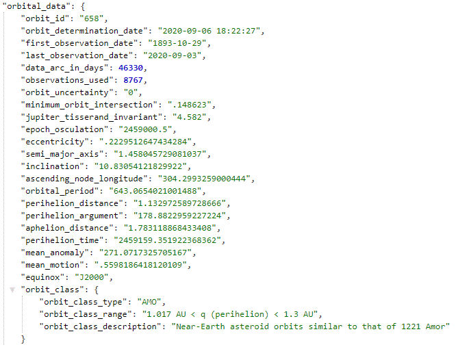

i'm doing a project where the goal is to get the relative position of a space object to the earth, roughly. Basically, i want to say that this object is currently e.g. above New York.
The data for any given space object that i have is
(It's sourced from an NASA API). The specific values are not important, just an example object.
I know nothing about how orbits are calculated and such, but I'm a pretty math-savvy guy and i'd be willing to research and learn it myself. But i don't want to spend 3 days digging into this stuff only to realize that what i want to do is not possible with the information i have.
So basically my question is the title. Also if you want to give me some pointers which of those values are important to me that would be amazing too.
This should be fairly straight forward. The orbital data from NASA should allow you to calculate the right ascension and declination of an object at the current (or any other) time. Once you have the RA and Dec you can calculate the longitude and latitude of the point on the Earth where the object is at zenith.
I don't have references, but Google will give you the math and code examples for doing this.
