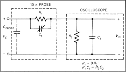

Here is a good intro from Tektrtonix about 'scope probe fundamentals:
www.ece.vt.edu/cel/docs/Probe_Fundamentals_Tektronix.pdf
A discussion of 'scope probe loading on circuits starts on page 32.
A 10:1 'scope probe has 9 MOhm in series with the input, to divide against the 1 MOhm input of the 'scope, as you can see in the attached figure from http://zone.ni.com/cms/images/devzone/ph/37d4325357.gif
That's how you get a nice high 10 MOhm input impedance to help avoid loading your test circuit. I don't know what a 1:1 probe would be, except maybe just straight coax. If that's what you used, you will need to look at your test circuit's impedances and the signal generator's output impedance and voltage level, to tell what the input impedance of the 'scope was. You should be able to figure it out from that.
