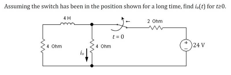

1. The problem statement
See attached question -
So I have this inductor transient question and can't seem to get the right answer. Basically I don't know how to determine the current in steady state after switch operation.
tau = L/C
iL = a+be-t/tau
V=IR
tau = 4/8 = 0.5sec
iL(0-) = 6A
6A = a + b
then I'm not sure what happens after switch operation.
Any help appreciated thanks!
