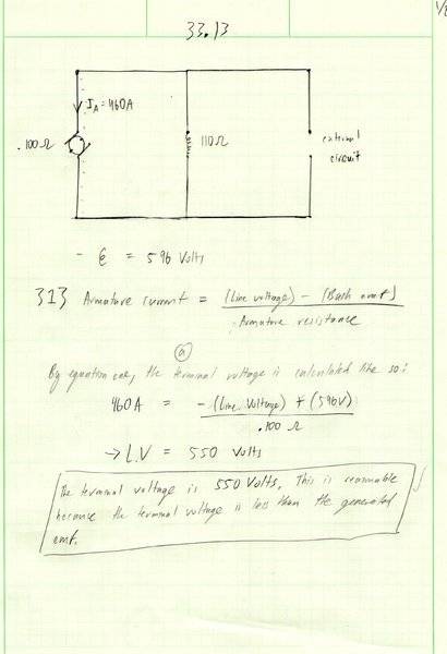

A DC generator's terminal voltage can not be greater than its generated emf (induced).
Draw the circuit diagram for shunt generator. Your armature current equation needs a couple of sign changes.

I drew a circuit diagram and re-did the problem. I got the right answers, but I still have a few questions. Are the sign changes only
necessary in order to ensure that the terminal voltage was less than the generated emf? Why is the armature's current equal to the sum of the field's and external circuit's current? I wrote down that was true because I found solutions to a similar problem that stated this fact. Thank you for your time.

DC generator supplies power to the external circuit, hence, armature current flows out of the armature winding through its positive terminal.
