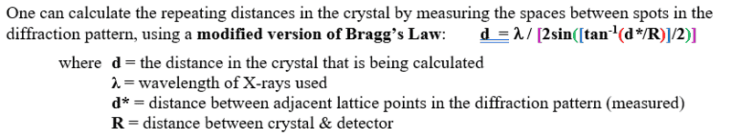

Modified Bragg's Law (given, also shown below)
$$ d = \frac {\lambda} {2\sin[ \frac {(\tan^{-1}(\frac {d^*} {R}))} {2}] } $$
##d## = distance in crystal
##\lambda## = wavelength used
##d^*## = measured distance between adjacent lattice points in the diffraction pattern
##R## = distance between crystal and detector
1.1) I see 4-fold rotational symmetry about the axis going through the center of the diffraction pattern perpendicular to the plane of the page
1.2) and 1.3) This is where I'm stuck. Once I get the horizontal spacing between adjacent lattice points, ##d^*##, the repeat distance in the crystal ##d## would be relatively straightforward to calculate using the above version of Bragg's law in 1.3. However, I'm confused about measuring ##d^*## along the horizontal axis of the diffraction pattern in 1.2. The separation between any two spots in the diffraction-pattern along the horizontal axis is not uniform, so how do I measure "the distance between adjacent lattice points" along the horizontal axis if its constantly varying?
