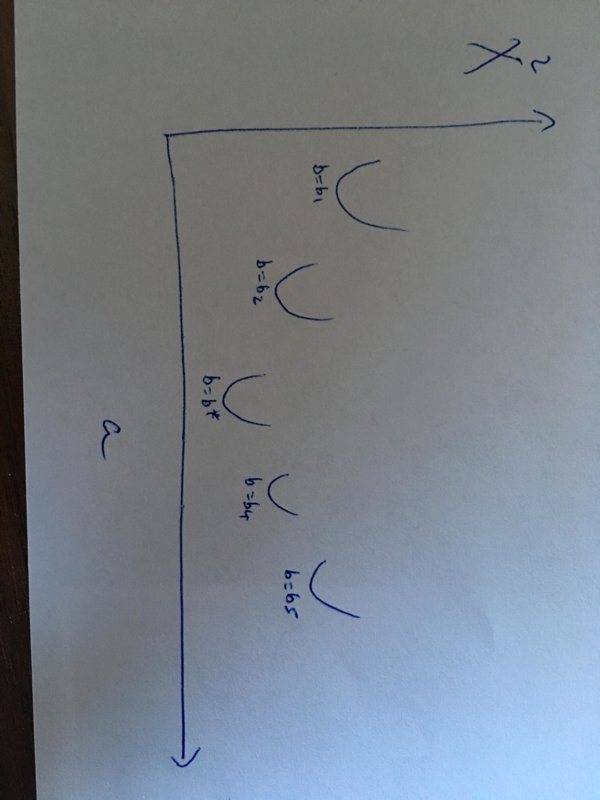

@Stephen Tashi Thanks for the comment. Basically if one wants to do a fit 'by hand', one can use an arbitrary value of one parameter to determine the best fitted value of the other by searching for a local minimum of chisq. Eventually, one may find the tuple ##(a^*, b^*)## corresponding to the global minimum of chisq. The search will be guided by intuition about the parameters and the form of the ansatz to be fitted.
In my case, the context being Physics, it is easy for me to find such a global minimum. I used five values of b and for each b I find a local minimum in the chisq. vs. a plot. Eventually I find a value of b and the corresponding a that gives the global minimum (see attached image). I wonder, is it possible to determine the covariance of a and b from this construction? I see articles on the net claiming the bootstrap can for example do this but that doesn't work with my intuition. Thanks in advance.
If you consider the fitting process as an algorithm that produces a unique result that depends only on the data, then the final answer ##(a^*,b^*)## can be considered to be a pair of random variables. From what you have said, the different trial values ##(a,b)## leading to this result have no obvious relationship to the final answer, so there is no justification for using them to estimate ##Cov(a^*,b^*)##.

I don't understand the probability model for the data - or whatever the fitted function represents. If the the data was (scalar) Gaussian data, you could fit a two parameter gaussian to it and one parameter wouldn't be a function of the other. I also don't understand how minimizing chi-square enters the picture. Are you using the concept of minimizing chi-square to get a different fit than a "least squares" fit? What is the format of the data? ##(x_i)##? ##(x_i, y_i)##? ##(x_i, y_i, z_i)##?
Also, I guess more automated fitting programs would compute the covariance matrix through computing the curvature matrix ( = second derivative of the chi square wrt parameters and result evaluated at best fit values ). I know Mathematica has this as a useable function but I suppose this is what it is doing in the background.
I'm not sure whether "best fit values" refers to values of the data or values of the parameters. If it refers only to values of the parameters, I don't see how statistical properties of the data are included in Mathematica's calculation.
Things that can be "computed" from a specific data are not population parameters. They can be estimators of population parameters. So you should distinguish between "sample mean" vs "mean" and "covariance matrix" versus "sample covariance matrix" etc.
For a given set of data, we have only one value for the best fitting parameters. So we don't have a "sample covariance matrix" for the parameters. We can use the sample statistics from the data to estimate the population covariance matrix for the parameters.
