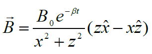

Let there be a magnetic field as posted below.
There is a square shaped loop with its center being at (2a, 2a,0). The length of the sides is 2a.
The loop is placed in the xy plane (z=0).
Determine the direction of the current in the loop.
This is supposed to be very basic, where the loop is held there is a declining magnetic field in direction (-z), therefore the current is supposed to be clockwise. However in the answers it is said the the current is anti clockwise. That doesn't make sense to me.
Is there a mistake in the answers?
Your answer "clockwise" looks correct to me (assuming ##B_0## and ##\beta## are positive and assuming you're viewing from above the x-y plane.)
Likes Eitan Levy and etotheipi
The induced current would oppose the change: so increase B in the -z direction. This is "clockwise" looking "down" at z (axial rotation vector in -z direction). Very clumsy nomenclature.
Likes etotheipi and TSny
