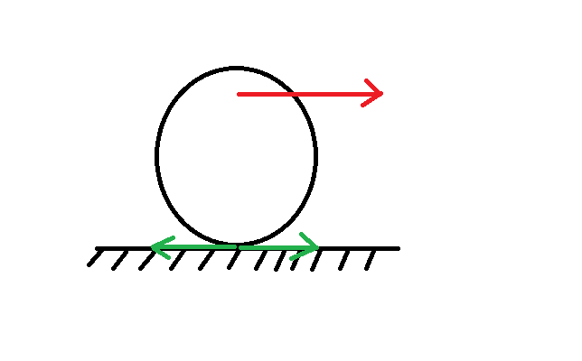

Hello everyone,
I cannot understand the logic behind determining the directions in the rolling problems. In all examples I have seen has a logic. Let us assume a rolling cylinder is moving to right as accelerating. If the cause of the acceleration is a torque the direction of the friction force is right. I can understand it as it is the only force exist and it has to be in the same direction as the acceleration.
In the examples I have seen another assumptation is that if the acceleration is because of a force (e.g. gravitational force on a inclined plane.) the friction force is in the opposite direction of this force. I don't understand why.
1) Let us assume I exert a force shown as the red. How can we know which one of the yellow ones will be the frictional force. Is there a mathematical way to prove this? (Maybe something about non-sliding condition but I want to see it mathematically)
2) Also I wonder how would I determine the direction if both a force and a torque existed.
3) Let us say this time the rolling ressistance is not neglected and I am not trying to accelerate but deccelarate. (In the below image the red arrow shows the force I exert and the blue one shows the rolling deformation.) How can I determine the direction of the frictional force?
4) The last question is about the non-sliping condition. If I know the ressistance and friction forces and the coefficient of friction between the surface and the cylinder, how can I determine the maximum force I can exert without causing it to slip?
Thanks in advance!
Last time I just understood that the direction can vary for the different cases. However I noticed that I hadn't understood how to determine the direction.
By the way I have done some calculations. If I am not wrong the direction can be determined by the two equations:
[itex]F=m.a[/itex] and [itex]\tau =I\alpha [/itex]
Let me propose my findings on my first question. I assume the friction is in the same direction with the red one.
[itex]F-F_s=m.a[/itex]
[itex]Fr_o-F_sr=\frac {1}{2}m.r.a[/itex]
If I replace "m.a" in the second equation:
[itex]Fr_o-F_sr=\frac {1}{2}Fr-\frac {1}{2}F_sr[/itex]
[itex]F_s=\frac {F}{2} \frac {r_0-\frac {r}{2}}{r}[/itex]
Then I can conclude that if the right side is positive the direction is the same with the red force, otherwise the direction is opposite. I think I can find the answers of question 2 and 3 with the same approach.
For the force limit, I think the maximum static friction mustn't be exceed, otherwise it will slide
You also have to relate [itex]a[/itex] and [itex]\alpha [/itex], via the radius. That is the no silip boundary condition.
Zalajbeg said:
[itex]F - F_s = m.a[/itex]
I would recommend using vectors with the same sign convention, so it's:
[itex]F + F_s = m.a[/itex]
Likes Zalajbeg

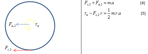

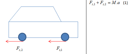

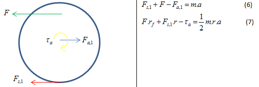

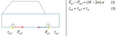

Thanks for your explanation. I wanted to do some calculations based on the knowledge I gained. It is about a vehicle braking. However I have a mistake somewhere and I cannot fnd it. Could you please check my steps?
My assumptations:
- The braking is done on a point over the wheel surface. The distance between the application point of the force F is rf
- The problem is 2D. Therefore the calculations can be done with two wheels.
- There is no slip
- The mass of the vehicle is M and the mass of every wheel is m.
- The radius of the wheels are r.
- The bearings are not ideal, therefore there are both forces and torques from the axles to the wheels.
The below pictures are four free body diagrams, respectively the vehicle, the vehicle without weels, rear wheel and front wheel. They also show the equations associated with them. The directions of the forces and torques are arbitrary, the exact directions will be determined by the signs. Also I used the scalar forms.
Fs is the friction force, Fa and τa are the force and torque from the axle respectively.
Firstly it can be seen that the left sides of the equation 4 and the equation 6 is equal:
[itex]F_{s,2}+F_{a,2}=F_{s,1}+F-F_{a,1}[/itex]
[itex]F_{s,2}=F_{s,1}+F-F_{a,1}-F_{a,2}[/itex](***)
After that I am opening the equation 2:
[itex]F_{a,1}-F_{a,2}=Ma-2ma[/itex]
Then I am replacing "Ma" with the left side of the equation 1 and "ma" with the left side of the equation 4:
[itex]F_{a,1}-F_{a,2}=F_{s,1}+F_{s,2}-2F_{s,2}-2F_{a,2}[/itex]
[itex]F_{a,1}=F_{s,1}-F_{s,2}-F_{a,2}[/itex]
Finally, I replace Fs,2 with the right side of the equation (***).
[itex]F_{a,1}=F_{s,1}-F_{s,1}-F+F_{a,1}+F_{a,2}-F_{a,2}[/itex]
[itex]F=0[/itex]
However it is not the case, F is a force determined by me, it doesn't have to be zero. Could you please explain me in what step I am doing wrong?
Who is applying F to the wheel? If the car, then (2) is wrong. If something external to the car, then (1) is wrong.
Likes Zalajbeg

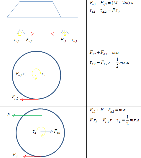

Today, I made two calculations with the above equations with the corrections regarding the discussion here. The bad thing is that the acceleration and most of the forces are found equal to zero. I checked the results with the original equations and the results satisfy.
The equations I used are (Also I tried wth no torque on the rear wheel):
I didn't show the vertical forces,the only equation they can be shown is the equation 2 but they cancel each other there. Could you please advise me a model which will not give me the acceleration value zero?
You didn't correct equation 2 now 1.
Sorry for sendind a wrong picture,
In my calculations I used the corrected form:
[itex]F_{a,1}-F_{a,2}-F=(M-2m).a[/itex]
However the result for the acceleration is always "zero". I can send the operations and the matrices (Gauss Elemination) tomorrow if you want to see. The only unknowns not equal to zero are the torque and the axle reaction force on the front wheel and they cancel the braking force.
How do you know the vertical forces from the wheels on the chassis produce no net torque?
Let us say the horizontal distance between the CM of the vehicle and the center of the front wheel is L1. And the distance between the centers of the wheels is L. The vertical reaction forces are N1 for the front wheel and N2 for the rear wheel.
First of all I am taking whole vehicle as the free body. The torque on the contact point (road and the weel) of the front wheel (which is zero as the vehicle is not rotating) is:
[itex]W.L_1-N_2.L=0[/itex] (***)
The friction forces (the only external horizontal forces) produce no torque as the point is on their direction.
After that I am taking the wheels as bodies. The vertical forces are: Fa,v (the vertical force from the chasis to wheel), mg (the weight of the wheel) and N (the reaction force from the ground). As there is no vertical acceleration Fa,v=N-mg. This is also the magnitude of the vertical force from wheel to chasis.
Now I am taking the vehicle without wheels as the body. The equation 2 on the pictures is the torque on the center of the front wheel.
[itex]T_{a,1}-T_{a,2}=F.r_f+(N_2-mg).L-W.L_1[/itex]
From the equation (***)
[itex]T_{a,1}-T_{a,2}=F.r_f+N_2.L-mgL-W.L_1[/itex]
[itex]T_{a,1}-T_{a,2}=F.r_f-mgL[/itex]
In fact I didn't take this mgL term into consideration. I have updated my calculations with this, the acceleration is not "zero" anymore but it is again independent of the brake force F. It doesn't seem logical as it would mean the vehicle will deccelerate even I do not press the brake pedal.
My calculations are in the attached file. (Most of them is Gauss Elimination).
  • Braking Calculations.zip
