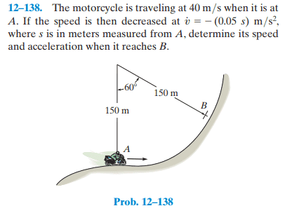

The motorcycle is traveling at 40 m/s when it is at A. If the speed is then decreased at [tex]v'=-(0.05s)m/s^2[/tex], where s is in meters measured from A, determine its speed and acceleration when it reaches B. I attached a picture of the problem.

Problem Statement: The motorcycle is traveling at 40 m/s when it is at A. If the speed is then decreased at [tex]v'=-(0.05s)m/s^2[/tex], where s is in meters measured from A, determine its speed and acceleration when it reaches B. I attached a picture of the problem.
Relevant Equations: [tex]S = S_0 + v_0(t) + \frac{1}{2}at^2[/tex]
[tex] v^2 = (v_0)^2 + 2a(\Delta S)[/tex]
[tex]s = r\theta[/tex]
[tex]a_n = \frac{v^2}{\rho}[/tex]
[tex]a_t = v'[/tex]
I figured since the motorcycle travels along an arc, I needed to get the arc length. [tex] s = 150m(60*\frac{\pi}{180}) = 157.08[/tex] .
Then since the tangential acceleration is constant, using the constant acceleration formula to find final velocity...
[tex] v = \sqrt{(40)^2+2(-0.05(157.08))(157.08)}[/tex] but that gave me an imaginary number since the acceleration is negative? I'm not sure if this is the correct process. Any help is appreciated!
It isn't, and your first two Relevant Equations aren't, since they only apply to constant acceleration.
I do not understand your calculation for "v". Although the label v is used it represents speed here, not velocity. What is the speed at A?
Oh! I see, because its a function of distance? So would [tex]ads = vdv[/tex] be more appropriate?
My "v" came from the constant acceleration formula but since it isn't constant, this will not work.
The speed at A is 40 m/s?
EDIT:
Wait I figured it out!
Since acceleration isn't constant and we're given the acceleration as a function of time.
Integrating both sides,
[tex]\int ads = \int vdv[/tex]
which gives me the final velocity and to find the acceleration magnitude, I used
[tex]a = \sqrt{a_t^2 + a_n^2}[/tex]
Thanks for the help!
