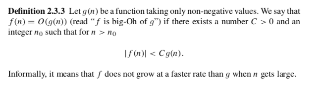

As for the comparison of g and h, to show that f does not grow at a faster rate than g when n gets large, we would need to show the following:
Do you think using this def given the functions g and h would be possible? I need to find either case of one growing faster than the other when n gets large. I can't see how you could intuitively see which case has a higher probability of holding so I just chose the case where g grows faster than h arbitrarily.
Does any of my working on the original post look useful in attempts to conclude growth via this def?
Thanks.

Yes, ##6^n## grows a lot faster than ##\log n##. There is no constant ##C## such that ##|g(n)|<C\cdot h(n)## for large ##n.## If at all, it is the other way around because ##6^n>n^c>(\log n)^c## for large ##n.##

But here we have the relationship log(n)^c < n^c < 6^n, where h(n) = log(n)^c for c = 84. But g(n) = 6^n/n^5 not just 6^n, so how can we extend the string of inequalities to fit g(n) such that log(n)^c < g(n)?
Because that way we could pick C = 1 > 0 and some arbitrary n0 such that the condition holds when n > n0.
##n^5 ## is small against ##6^n## so we can write ##O(5^n) <g(n)=\dfrac{6^n}{n^5}<6^n=O(6^n)##. Hence we don't have to bother: It would be ##O(c^n)## for some number ##5<c<6## if we make more precise.
##h(n)=(\log n)^{84} = O(\log (n)^{84})< O(n^{84}) < O(6^n)=g(n)## for ##n>260.##
