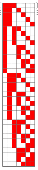

The closest thing I've found to this subject is multisets, but the function ##\left(\!\!{a\choose b}\!\!\right)## isn't quite right. I have included an image which is similar to the output list of arrangements from the algorithm. In the picture, each cell would be a bucket. the red represents a rock's presence. Moving down a line indicates how the algorithm moves one rock at a time in order to go through all the arrangements. The image is not perfect because multiple rocks in the same bucket are not represented.
Multisets don't have bucket size limits. The O(kN) algorithm should be fine for all practical purposes.
Since your looking for a formula to test your algorithm, I'd go with what jedishrfu said about partitions. Where each term in the sum of a given partition is a bucket. A particular subset of all partitions of an N will give the exact answer, but no good way to pick this out; that I know of. But, Sterling's approx will give a decent upper bound, as it calculates total number of partitions as N approaches infinity. A modification to the formula could get you closer, but not sure on what that would be in general. I'd follow link jedishrfu gave, if haven't already.
