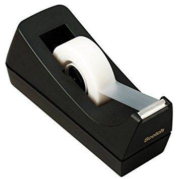

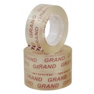

berkeman said:
So can you think of ways you could amplify the small displacement from the thin dielectric layer? How transparent is the tape?
Can you post a picture of the tape, or link to the product? There is another trick that you can use to get around the thinness of the tape sample... :smile:
Like: https://images-na.ssl-images-amazon.com/images/I/41wtuh6hckL._SY355_.jpg
I can use a lot of connected layers but transparency is so low then.
That picture holds the key to the trick I was thinking of. Did you ever see the old Star Trek movie "The Wrath of Khan"?

kubajed said:
Do you suggest to experiment with 3D?
Not exactly. The point is to think of other geometries that you could use to take care of the problem of having such a thin sample.
Back when I was in high school, I found a short book on problem solving (I wish I could remember the title). It gave lots of tips and tricks for solving all kinds of problems, as well as general techniques for ways to think about problems. One of the best tips was when you were presented with a difficult problem that had obstacles to its solution, think about ways to turn things around up upside-down or some other way (physically or conceptually) to see if those alternative views gave any clues to ways to get past the obstacles.
I believe that I came up with a good trick for you to use to do this experiment, and I used that tip from the book on problem solving to get to it. Hope that helps. :smile:
