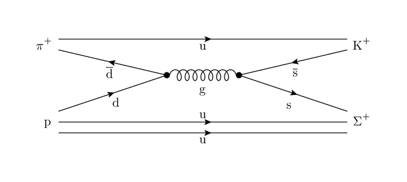

Just testing my current knowledge- would the particle ##X## be a ##\Sigma^+## ? And would this be the corresponding Feynman diagram?
Also, rather than a gluon, could the mediation particle be a photon or ##Z^0##?

Also, rather than a gluon, could the mediation particle be a photon or Z0Z0Z^0?
quarks prefer interacting with gluons rather than photons (or even worse the massive Z bosons)... so to your question the answer is yes but not as likely.
W's apart from being heavy also have Cabibbo suppressed vertices.
