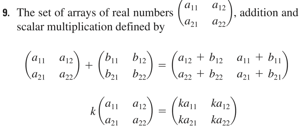

Question: determine whether the set is a vector space.

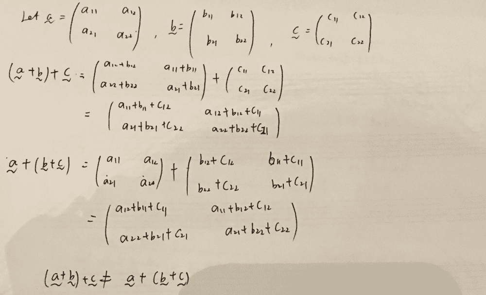

The answer in the solution books I found online says that the set is a vector space. However I do not think the set satisfies the associative law of vector addition:
Can anyone tell me where did I go wrong?
PeroK said:
Which book is this? There's a serious misprint in the definition of matrix addition.
Maybe this is the question: Is the addition defined in that way the addition of a vector spaces?
Likes Marc Rindermann, archaic and member 587159
Yes, of course. But, that operation can't possibly be associative!

It looks like you are right.
You just need to look at ##c_{11}##, say, If you do ##a + (b + c)##, then ##c_{11}## goes to the second column, then back to the first. If you do ##(a + b) + c##, then ##c_{11}## goes to to the second column. That addition operation cannot be associative.

Was the "solution" you looked up the solution to this specific question? That is, was the solution set written for this book? Matrices with the standard matrix addition and scalar multiplication do form a vector space but this is NOT "standard" matrix multiplication. It may be that this non-standard addition was given as an exercise to see if you are paying attention!

It was the solution to this specific question. Matrix addition and scalar multiplication are defined as such in the question, ie. the question does not assume standard matrix addition and scalar multiplication. the question was, determine whether the set on which the matrix addition and scalar multiplication are defined as such is a vector space.
Thank you very much!

You are misreading the problem. It doesn't say anything about matrices! It talks about the set of arrays with the given definition if addition.
Tomayto, tomahto. The image attached in post #1 shows a 2 X 2 array of numbers -- a matrix. It just so happens that the set involved includes matrices as described, but with the operations of matrix addition and multiplication by a scalar defined in ways different from the usual.
No, a "two by two array of numbers" is just that, it is NOT by itself a "matrix". A matrix is a an array of numbers together with a standard definition for multiplying and adding those arrays. Here we are given a two by two array of numbers with a definition of "multiplication" that is different from that standard definition.

For a set of matrices (= rectangular arrays of numbers) to be a vector space, the operations of matrix addition and scalar multiplication have to satisfy the usual list of vector space axioms. The addition and scalar multiplication operations don't have to be the usual ones.
As much as I hate to- I will have to agree with you! But I will still disagree with Perok, to whom I was originally responding, when he said that the given definition of matrix addition was "wrong"!
Yes on PeroK. He was assuming that the matrices had the usual definitions for addition and scalar multiplication, and that there were typos in the problem statement. Problems like the one in this thread are pretty standard in lin. alg. textbooks, where you have a set of matrices with unusual definitions for the two operations, and the student is asked to decide whether the set of matrices plus the two operations constitute a vector space. I'm sure you know this.
