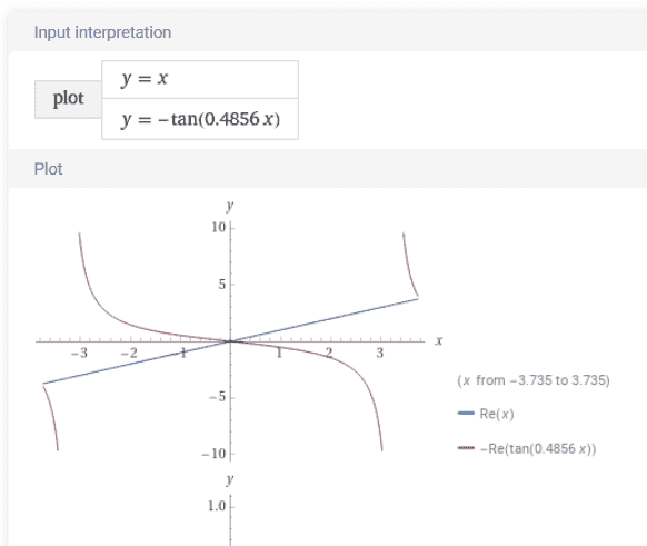

- Homework Statement
- I believe I solved the transcendental equation but the plot does not make sense.
- Relevant Equations
- ##k_{1} \cot{k_{1}R} = -k_{2}##
##k_{1} = \frac{\sqrt{2m(E+V_{o})}}{\hbar}##
##k_{2} = \frac{\sqrt{-2mE}}{\hbar}##
##x = -\tan{bx}##
##x = \sqrt{\frac{-(V_{o} + E)}{E}}##

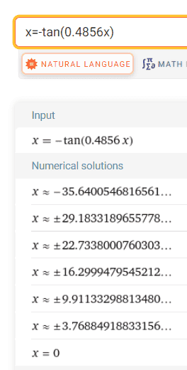

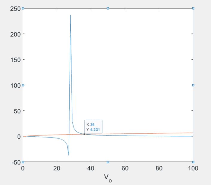

When rearranging we get ##b## as.
##b = \frac{\sqrt{-2mE}}{\hbar}*R##
For the reduced mass ##m = \frac{1.67x10^{-27}}{2} kg##
For ##\hbar = 1.054x10^{-34} J-s##
For ##E = -2.22 MeV##
We are suppose to see that when solving the transcendental equation we get ##V_{o} = 36 MeV##. However we must have something wrong because the function does not clearly show how you infer the ##V_{o} = 36 MeV##. Any help is appreciated.
