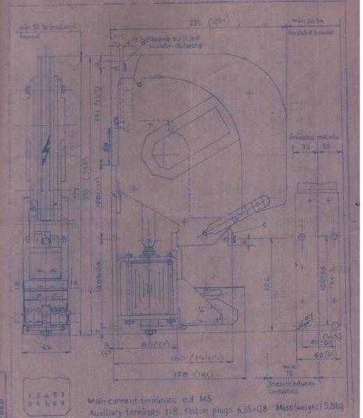

I am designing a contactor for both DC and AC mainly for polarity independent circuit-breaker. It has a contactor unit, actuating solenoid, arc chute, Electromagnetic arc blow out coil Auxiliary contacts and base plate. Basically i got stuck in the Time constant measurement, ie the Bracking and Closing time. What does parallel connected diode to coil signify?
The time constant measurement without protective device, with parallel connected varistor to coil, with parallel connected diode to coil all are coming the same.
Attaching the drawing of the same for better understanding.
I cannot make out any detail on that drawing.

As I said the drawing is illegible.

Mr. Hardy, Carl thanks for those inputs.
I will try to break it down and be as descriptive as possible. We are actually trying to reverse design and upgrade.
Now about the basic construction, It has Contact Unit, Actuating Solenoid, Arc Chute, Electro magnetic arc blow out coil auxiliary contacts and a base plate.
The Contact unit consists of a fixed contact holder and a moving contact lever. Both parts are fitted with silver tips. There are spring mounted to avoid contact bounce.
The movement of the contact is a gliding movement. Actuation of the moving contact is done using te solenoid plunger and actuating lever. It is opened by armature resetting spring. The actuation of the moving contact is achieved electromagnetically and it is opened by resetting the spring after holding current has been switched off.
It is just the energizing and de energizing mechanism. The blow out coil ensures rapid and reliable extinction of arc. The auxiliary contacts are basically snap switches NO or NC. Voltage for drive 110 VDC.
Now my problem is with the opening and closing time of the fixed and mobile contact when energized or energized.
I am unable to achieve the closing time of 100ms. and interrupting time of 8-12ms. without protective device.
I have to increase the closing time atleast by 20-30ms, because am getting somewhere around 53-55ms, where as it shout be 80-100ms.
And my braking time is just about 60ms, whereas the interrupting time mentioned is about 8-12 ms.

Exactly right, sir.
The closing time is faster than required and the opening time is slower than expected.
The coil that we are using is about 450-470 ohms.
We will start with tial and error procedure by increasing the tension of the spring first. The air gap between the contacts also need to be modified.
Sir, can you please enlighten me about the voltage regulator coil stops that you have mentioned.
Yes sir, the old contactor also was based on the same principle but there was no time constant requirement in that. We just had to make sure that the contacts closed when the current was applied.
So as far as I can get, we need to fiddle around with the air gap and the spring tension to get the required time constants.
