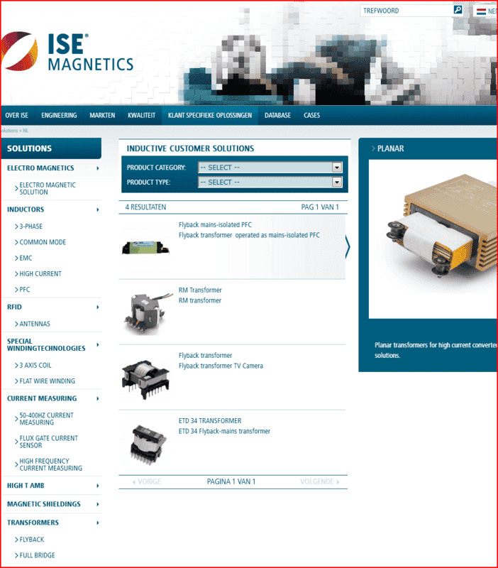

I am in the process of trying to use the program Target 3001 to transfer a circuit board image to a workable schematic, but I am running into difficulty locating any info on a flyback.
Hi,
I am trying to eventually produce a schematic from a populated circuit board using the program Target 3001. I have been carefully locating and identifying as many parts on the board as possible for ease of placement later, but there is one problem: the board has an old nine pin flyback transformer for which there doesn't appear to be any data either in the search areas that the program recommends, nor through googling.
The program has options for drawing "packages" and "symbols" in aforementioned cases, but for something like a flyback where I can't see what goes where internally, I'm not sure how to do this. By the way, the flyback number is FMH-1232BE (maybe you'll have better luck than I did!).

Goggling the part number probably got you to the ISE website like it did for me. But I don't get a match at the ISE website using their search engine.
Every product that I've designed or worked with that contained a flyback transformer used a custom or semi-custom design. I don't think there are too many off-the-shelf flyback transformers, certainly not for low-cost consumer products.
You might try sending an inquiry to ISE to see if they did produce that flyback for that product. They may not be able to tell you or send you specs (because of proprietary agreements), or maybe it's been long enough now that they wouldn't mind sending you the specs.
Likes DaveE
Actually, no, that was not a website I came across during my search. What is the link please? Thank you.

Oh, it might be because I added a word to my search: flyback FMH-1232BE
Here is the link: https://www.isemagnetics.com/oplossingen/index.php?SECTION_ID=190
