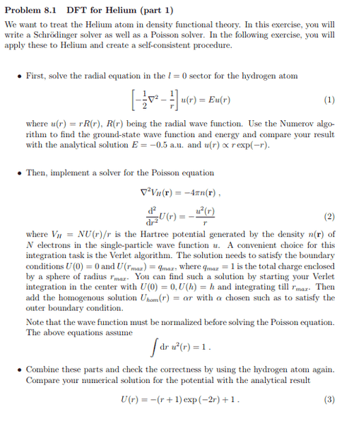

I'm trying to solve this problem with Mathematica.
Im not a Mathematica expert, but my program works perfect when vhartree={0,0,..,0}.
This is the program I wrote:
The problem arises when vhartree is not zero. In books: 2energy-integrate2= -2.861, I get: -3.89561. I would appreciate any suggestion, thanks in avance for your help. In this page, you can find the code in Python for the whole problem (including the exchange potential):
<https://www.leetspeak.org/teaching/cqp_fs14/09-dft.html>
