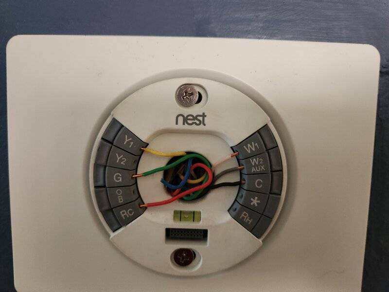

Thinking to debug on my own, I research the connections, find the above video and start poking around. In my poking, I must have changed something in the behavior, probably while I was figuring out how to manually bypass the thermostat. The first time I tried it, the system shut down, I must have tripped a current fault somewhere in the system. Ever since then ...
Nest cannot or will not energize "Y" and the condenser never turns on. I have two Nest thermostats and they both work fine with one of the systems in my home and both have the identical bad behavior in the other system.
I confirmed with a multi-meter that when the Nest says "Cooling", "G" is energized but "Y" is not. The fan is blowing, and the condenser is not on.
Specifically, at the control board in my attic -
R to C gives 24V AC : Power is ok
G to C gives 24V AC : Fan control is energized, fan is on
Y to C gives 0 AC : Condenser is not energized, condenser is not on (unexpected)

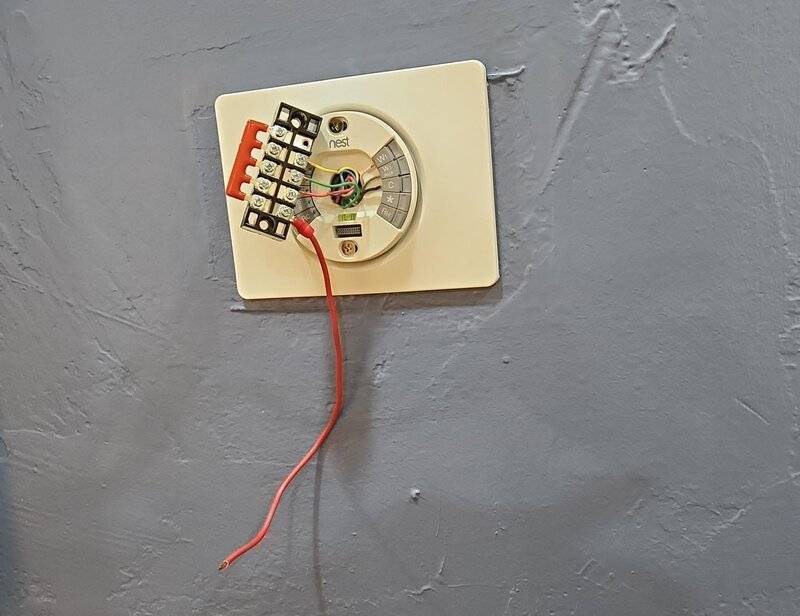

I remove the Nest, short R,Y and G and the system (both condenser and fan) turns on normally and cools normally, as I would expect.
I have two cooling systems in my home, they are of different makes, though. One is Trane, one is Lennox. Both are controlled by a Gen 1 Nest.
I swap Nests, and the behavior stays with the system. So both Nest thermostats operate the Trane system normally, and neither Nest turns on the Lennox condenser. So I don't think the Nest unit is faulty.

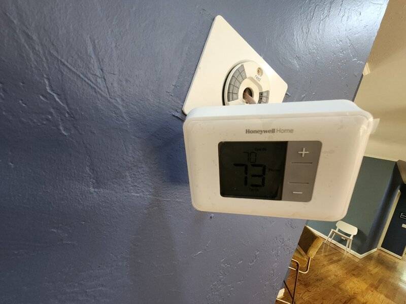

Thinking the Nest Gen 1 signal drivers might be marginal with the control board on my unit, and as the stuff aged some property of the Y signal changed just enough to put it out of reach, I bought a basic not-smart Honeywell thermostat can tried it out. It works fine. When I turn it to cool, the fan and the condenser come on and the system cools normally.
My Nest units are Gen 1. Does anyone suspect a Gen 3 Nest might work differently?
I find it very odd that the Nest does not throw an error when Y is not energized and the Nest is in a mode such that it must be intending to energize Y (the cooling mode). I speculate there may be some current fault detection in the Nest driver that is hardware-only, but I can't think of any way to test for that and I can't find any reference to such a thing on-line.
C is connected to the Nest and the A/C controller, btw. Its an optional connection according to Nest installation instructions, I have it connected and always have.

The 2 leading possibilities:
1. A cable defect (marginal) between the Tstat and the AC
2. An intermittent defect at the main contactor coil.
I've seen both (standing in my backyard at 2:00 AM in my underwear). While not always the case, these kind of intermittent AC issuers are often related to moisture. The cable is subject to atmospheric and (for buried wire) soil moisture. Troubleshooting these is not fun.
-Replace the (or temporarily run a substitute) cable.
-Make sure that nothing (mice, insects...) has set up residence in the control enclosure and there is no excessive dirt/moisture.
Likes russ_watters
@Dullard The cable from the condenser to the blower was replaced by the tech, that didn't change the hiccups. The thermostat cable is short, up the wall into the attic and into the blower, but its quite old and could be marginal.
Along those lines, I wonder if the Nest backplate connector where the Nest plugs in could have a marginal mechanical connection at the Y port. I can swap Nest backplates to check that.
I can easily run a parallel cable, thanks for the suggestion.

1) remove thermostat
2) jumper the wires at the thermostat socket to simulate what the thermostat should do
Does the system come on (operate) as expected?
Yes) Either the thermostat(s) failed​
-OR-​
whatever the thermostat drives is faulty​
No) Remove the jumpers and leave the thermostat disconnected​
Connect the jumpers to the appropriate wires in the A/C unit​
Unit works: suspect wiring between unit and thermostat​
Unit does Not work: Well, at least you have localized the problem (sort of) :cry:
Start troubleshooting the things mentioned at the start of this post.​

@Tom.G Thanks for the response. I've had a different non-Nest thermostat on the system since I made the OP, and all of the symptoms are gone, the system is working normally. I did the test you describe, and I am here with my own reasoning -
Yes) Either the thermostat(s) failed-OR-whatever the thermostat drives is faulty
The thermostat drives the Nest back plate, then the thermostat wire, then the system control board in the blower in my attic. The new thermostat uses the same wire, but a different type of back plate than the Nest. I think the wire is ok, because both thermostats use it. I don't have any way to test if the control board is marginal and will work with some thermostat drivers but not others.
I can't test the new thermostat with the old back plate, but I could put the old back plate on the 2nd system in my home and see if it becomes faulty. At this point, though, with all systems working, I think I will let further debug lie and live with having two different kinds of thermostats in my home.
