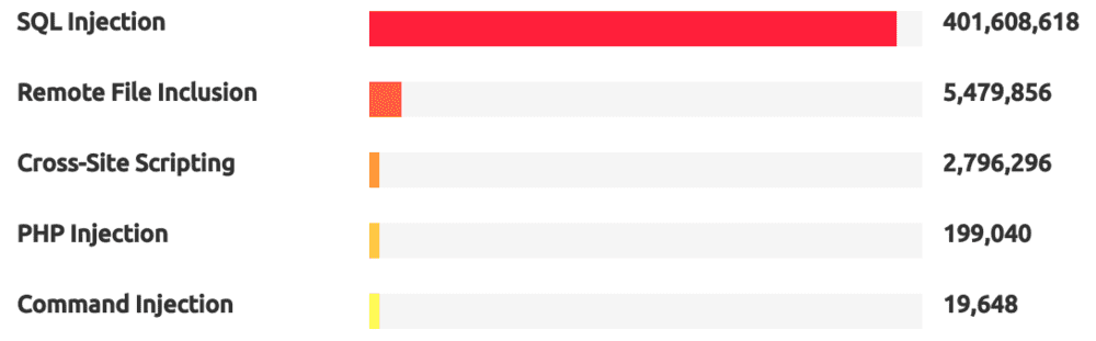

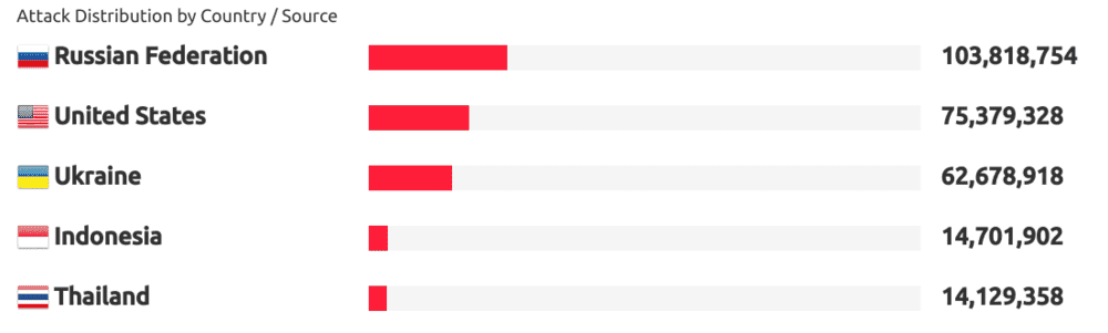

You can always check this source for recent attacks. Sometimes, you see spikes on specific days.
https://www.akamai.com/us/en/resources/our-thinking/state-of-the-internet-report/web-attack-visualization.jsp
Here's data from the past week.
Likes Klystron and Nik_2213

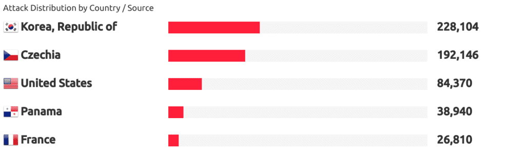

You can filter the Akamai report. Here's one on power grid attacks last week (my personal interest)
