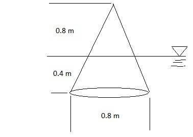

Given:
diameter 0.8 m
height 1.2 m
floats in water
how far will it sink in a liquid (density =1360 kg/m^3)
Buoyant force
In the attachment
I'm stuck on how to find the volume of the submerged cone in the liquid
please help

You are doing well, so far. Hint 1: Write d (or r, or x) as a function of L.
This what I think: since the liquid is more dense than water, then the cone will float a little. From triangle, 0.8 becomes 0.8+y and 0.4 becomes 0.4-y. The ratio and proportion becomes 0.4/1.2 = x/(0.8 + y). Am I correct? or the cone will sink a little?
No. Hint 2: 0.4/1.2 = x/L.
To find the volume of the submerged cone, you can use the formula V = (1/3)πr²h, where V is the volume, r is the radius of the base (diameter divided by 2), and h is the height of the cone. In this case, the radius would be 0.4 m and the height would be the distance the cone sinks in the liquid, which we will call x.
Next, you can use the formula for the buoyant force, Fb = ρVg, where Fb is the buoyant force, ρ is the density of the liquid, V is the volume of the submerged object, and g is the acceleration due to gravity (9.8 m/s²). We can set this equal to the weight of the cone, which is equal to its mass multiplied by the acceleration due to gravity, mg.
So, we have ρVg = mg. Substituting in the values we know, we get (1360 kg/m³)(π(0.4m)²x)(9.8 m/s²) = (m)(9.8 m/s²). We can solve for x by dividing both sides by (1360 kg/m³)(π(0.4m)²)(9.8 m/s²), giving us x = m/π.
