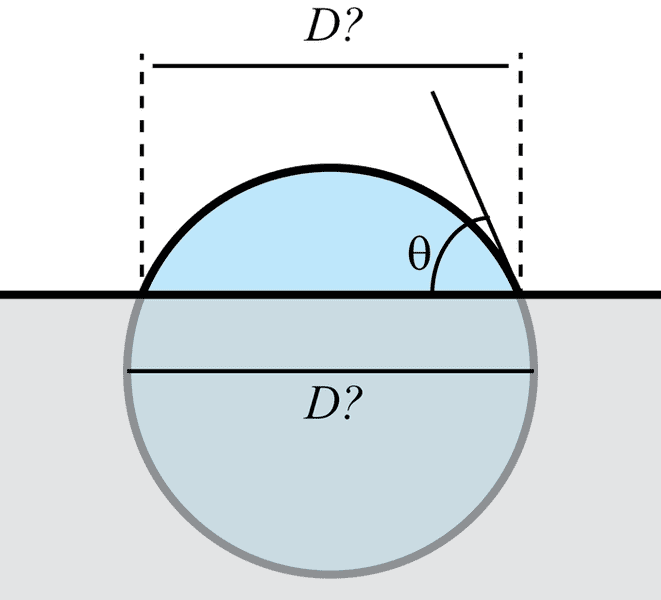

Hi,
I'm trying to understand the derivation to an equation I found in the following paper: http://pubs.acs.org/doi/abs/10.1021/nn203035x
I posted almost this exact question on Physics Stack Exchange but got no replies so I decided to try it here instead, I hope that's ok!
http://physics.stackexchange.com/questions/306409/diameter-of-nanoparticles-formed-by-solid-state-dewetting-of-thin-filmsThe paper discusses the solid state dewetting of an ultrathin (~nanometer thickness) metal film into small nanoparticles. Specifically they state that the nanoparticle diameter ##D## will depend on the initial film thickness ##h## and the contact angle with the surface ##\theta## as:
$$D = \frac{6h\,\sin \theta}{1-\cos\theta}$$
for ##\theta<90^{\circ}## or
$$D = \frac{6h}{1-\cos\theta}$$
for ##\theta>90^{\circ}##
First of all I don't understand how they arrive at this equation. Secondly I am not sure what they define as the 'particle diameter' ##D##.

Question 4: And one final question that might be important: how do we define the diameter ##D## if the contact angle ##\theta## is below 90 degrees? See the picture at the bottom. Is ##D## the diameter of the particle that we would observe if we looked from the top, e.g. the "base"? Or is it the diameter of the particle if we imagine it extending below the surface?I must be missing a crucial step because I can't figure out how to get to the equations for ##D## above. I figured some math on spherical caps may be useful so I found this:

I have gotten a little bit further I believe. I imagined the thin film being cut up into many square blocks, where each block is transformed into one particle. Therefore the volume of such a block should be equal to the volume of the particle. I called the width and length of the blocks ##w## so its volume is ##hw^2## (as ##h## is the initial film thickness).
I made the following assumptions:
  • ##A## is the surface area of such an initial block. Therefore ##A = w^2##.
  • ##S_2## is the surface area of the spherical cap, which is ##S_2 = \frac{\pi d^2}{4} \left(1+\tan\frac{\theta}{2}\right)##
  • ##S_{12}## is the bottom / contact surface of the particle: ##S_{12} = \frac{\pi d^2}{4}##
Then using ##A = w^2 = S_2 - S_{12}\cos\theta## I have an expression for ##w##.
Finally,
$$V_{\rm{block}} = V_{\rm{particle}}$$
$$hw^2 = h \left(S_2 - S_{12}\cos\theta \right) = V_{\rm{particle}} = \frac{\pi d^3}{48} \tan \frac{\theta}{2} \left(3 + \tan^2 \frac{\theta}{2}\right)$$
When I solve this equation for ##d## using Mathematica and simplify the result, it tells me (remarkably) that the solution is
$$d = 6h\sin\theta$$
Close... But not quite what the paper states, I'm missing the ##1-\cos\theta## fraction for some reason.
I can't see where I'm going wrong in my math. Maybe my definition of the diameter is not the same after all?
