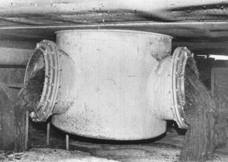

@Nik_2213 I don't think so, it is wrong to imagine the red hot lava being thrown into a large pool all at once which surely if a large hot mass gets suddenly introduced to large amounts of cold water can cause a violent steam explosion, just because the RBMK did not have a western style reinforced concrete dome around it doesn't mean it was built from paper and plastic exactly.
The reactor still had a thick reinforced concrete so called "biological shield" around the graphite/pipe channel structure which was filled with sand and lead, altogether the thickness was few meters, underneath the reactor were the pipe inlets for each channel (imagine a large pipe network) underneath that was a reinforced concrete pool meant for suppressing a leak if one or two of the channel pipes burst. The hot lava was not introduced to the bottom of the reactor all at once , it moved slowly just like you imagine a large hot mass breaking through concrete and steel , in the process it cooled off a little and mixed with all kinds of crap.
At best it could have boiled the water below and caused radioactive steam to spread in all direction that's about it. But compared to the amounts of steam and ash already blown into atmosphere this would be just a minor thing in the overall scheme of matters.
243699
Notice how the lava has stopped and solidified within a steel diverter pipe which means that once the lava broke through layers of concrete and steel it was already cool enough and incapable of melting any more steel.
Basically the only real danger for the red hot fuel mass was that it was very toxic and radioactive so they only tried to contain it within the building and not let it out and that's all , everything else is speculation and fake news.
