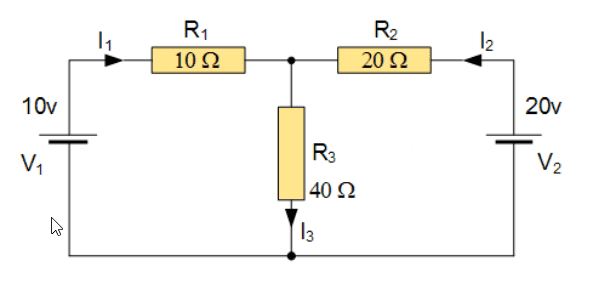

Here's a better picture

It is indeed much better! Thanks.

I will show that ##I_1## is negative:
$$50 I_1 + 40 I_2 = 10;\ 40 I_1 + 60 I_2 = 20 \\
5 I_1 + 4 I_2 = 1; 2 I_1 + 3 I_2 = 1\\
3 I_1 + I_2 = 0$$
Note that ##I_1## and ##I_2## have different signs and that ##I_3 = -2 I_1##, so ##I_3## and ##I_1## have different signs. And since ##I_2## is clearly positive, we know all the signs and ##I_1## is indeed negative.
You are on the right track, good work so far!
Do you know about Thevinin & Norton equivalent circuit transformations yet? I think they make problems like this much easier to do.

Alright, thanks for the verification. So far we've only been taught ohm's and kirchhoff's laws.
