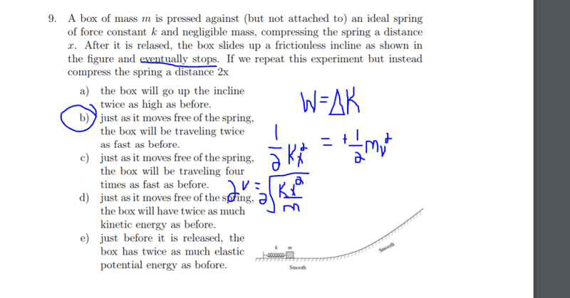

Did i do this problem right? (Work by Spring and KE)

Lori
W= KE
Wspring = .5kx^2
since W = .5mv^2 = Wspring = .5x^2
i solve for v and get that v = sqrt(kx^2/m)
if i plug in multiply the x by 2, the 2 squares and i get 4. the square root of 4 is just 2 and it comes out as a constant , and so velocity is 2 times faster
Did i go through the problem correctly?[/B]

Lori said:
W= KE
Wspring = .5kx^2
You got the right answer for the right reasons. You might like to think, however, about how you could organise your working better.

You are right but if you have to write what is relation between heights
mgh + 1/2mv^2=PE of Spring + mgh
mgh + 1/2mv^2 = .5kx^2 + 0
mgh + .5mv^2 = .5k(2x)^2
mgh + .5mv^2 =4 (.5kx^2)
since m and g are constant in the left side of the equation, the coefficient 4 will affect the height and the speed of the object and the final KE
height will be 4 times as big and the velocity would be twice as fast at final, while the final KE will times 4
When block will reach its maximum height velocity will be zero at that instant simply applying energy conservation at that instant you will get the result
How would you write the equation?
How is the one I wrote above incorrect?
In energy conservation E2 = E1
(Final energy) PE2 + KE2 = PE + KE1 (initial energy)
When block reach max height at that instant velocity seized and no kinetic energy
. 5kx^2=mgh

Oh I see. So in this spring problem. The initial energy comes from PE of spring.
The final energy comes from the gravitational energy since kinetic energy is 0 (because the object stops)

Yes you got it
