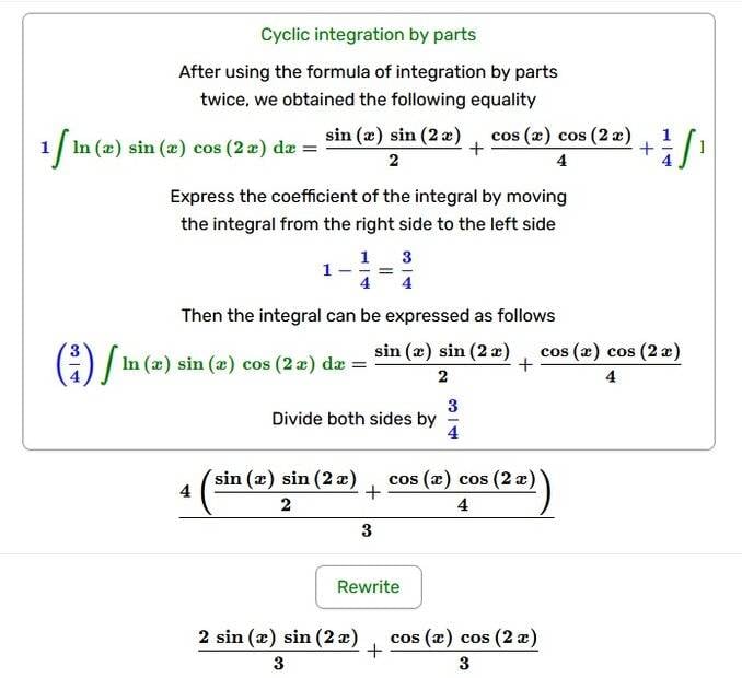

But for the moment, I'm more concerned with whether or not Math DF's integral calculator got it wrong than I am concerned with showing that two different solutions to ##\int{\ln\left(x\right)\,\sin\left(x\right)\,\cos\left(2\,x\right)}{\;\mathrm{d}x}## are equivalent. Math DF's solution is as follows (it'll be easier for me to just post screen shots than it will to put it all in LaTex code here, as some of the LateX code at Math DF can be copied, but much of it can't be copied):
The calculator chooses to go with Integration by Parts to start, and right away, in breaking the integrand up into a ##u## and a ##dv##, it doesn't account for the entire integrand. Specifically, it chooses ##u=sin~x## and ##dv=cos~2x~dx##, and leaves the ##ln~x## out completely. These IBP calculations would make sense for ##\int sin~x~cos~2x~dx##, but not for ##\int{\ln\left(x\right)\,\sin\left(x\right)\,\cos\left(2\,x\right)}{\;\mathrm{d}x}##...unless am I overlooking something.
As for this second part of their solution, the calculations I see here seem to make good sense so long as the calculations that got them to this point (performing IBP twice) are correct. But again, I can't be sure that this calculation is correct because I don't know that they got their integration by parts correct in the first place...and on the surface, it appears that they got the IBP calculations wrong.
In summary, are their IBP calculations correct and am I just overlooking something simple? Or did Math DF's integral calculator make a blatant error in leaving the ##ln~x## out of their IBP calculations?

SmartyPants said:
Or is this statement true (and is Math DF screwing up its IBP calculation)? It seems to me that Math DF is only integrating part of the original integrand and just throwing back in the part it left out (##ln~x##) after having arrived at an answer for ##\int sin~x~cos~2x~dx##.
It's hard to say whether Math DF is screwing up, as the image you attached in post 1 doesn't show the complete equation in the first equation they show. This is the one in which the left side is ##1\int \ln(x)\sin(x)\cos(2x)dx = \dots## and the right side looks like ##\dots + \frac 1 4 \int 1##. That final character looks like the digit '1' but probably is 'l' (lower case L). I have not written the two fractional quantities that precede this integral. The complete final integral has to be ##\frac 1 4 \int \ln(x)\sin(x)\cos(2x)dx##.
As it says in the image, they have performed IBP twice, but it's difficult to determine exactly which substitutions they have used in each one.

Yes, it's a bug. It only calculates [itex]\int \sin x \cos 2x\,dx[/itex] by integrating by parts twice; the [itex]\ln (x)[/itex] is completely ignored. It's not an issue with having three factors in the integrand, since it seems to do [itex]\int x \sin x \cos 2x\,dx[/itex] correctly.
You can simplify the integrand by using [tex]
\sin x \cos 2x = \frac12 (\sin 3x - \sin x).[/tex] The calculator does produce the correct answer for [itex]\int \ln x \sin ax\,dx[/itex].

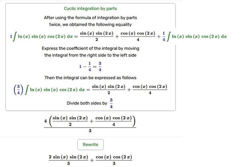

Hmm...I doctored that image to show the entire equation before posting it...weird that it's not showing you the entire equation. At any rate, you are correct - the part that got cut off is ##\frac 1 4 \int \ln(x)\sin(x)\cos(2x)dx##. Also, the picture does show what substitutions were made for ##u## and ##dv## in each IBP it performed, right in each "integration by parts" box...unless that part of the first picture got cut off as well.

##\sin x \cos 2x = \frac12 (\sin 3x - \sin x)## - this is the trig manipulation I used to get to the final solution. And thank you for confirming for me that Math DF appears to be leaving something out of the IBP calculations, or at the very least skipping a number of steps that I wasn't able to visualize in my head. Math DF tends to sometimes skip steps that might be obvious to Albert Einstein, Terrence Tao, and Richard Feynman, while not realizing that they aren't always obvious to us mere mortals LOL. I just wanted to make sure that I wasn't going crazy haha.
*EDIT* - Also, I did exactly what you did and replaced ##ln~x## with ##x##, calculated [itex]\int x \sin x \cos 2x\,dx[/itex], and it did that one correctly...who knows why it's leaving the ##ln~x## out of the other integral.
