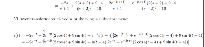

Hey, I get a different answer than the solutions manual. Did my prof do this laplace transform wrong?
Basically I think the 2 in-front of e^-2t should be a 1 instead.
thanks for help :)

looks like an extra 2 to me!
