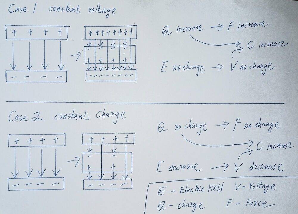

I am not able to intuitively understand the reasoning behind why the presence of dielectric between oppositely charged plates, let's say, reduces the force of attraction between the plates. I understand to some extent that electric field lines prefer to flow through dielectric (or insulator) than a vacuum, but I am not able to grasp clearly how this drops the force of attraction between the charged particles. Shouldn't the number of field lines be the same in both instances (i.e. different relative permittivities)? I am missing something fundamental here.
I think there are two different situations.
The first situation is that when the dielectric slides into the gap, the voltage of the capacitor remains constant ( connected to a battery ), so both the energy and the attractive force will increase.
But in the second situation, the voltage source of the capacitor is removed, and then the dielectric slides into the gap, so the energy and attractive force will be reduced.

Thanks but I still don't get the intuition behind this (instead of math). Can you explain how the force changes in terms of field lines?
First of all, I want to correct what I said. When the voltage source of the parallel plate capacitor is removed and then the dielectric is slid into the gap, the attractive force between the two plates of the capacitor will not decrease. In fact, this attraction remains the same.
In addition, I didn't have time yesterday, but today I finally have time to think carefully about this thing and draw the intuitive electric field line diagram. Hope this diagram is of reference value for you.
Likes artis, iVenky and eq1
In addition, I didn't have time yesterday, but today I finally have time to think carefully about this thing and draw the intuitive electric field line diagram. Hope this diagram is of reference value for you.View attachment 278482
I really appreciate you spent some time drawing the diagram (the diagrams look amazing by the way). Thanks so much!
The attraction might increase a little because the field becomes more gathered in between the plates. The dipole-like curved field around the edges becomes weaker with the dielectric, right?
