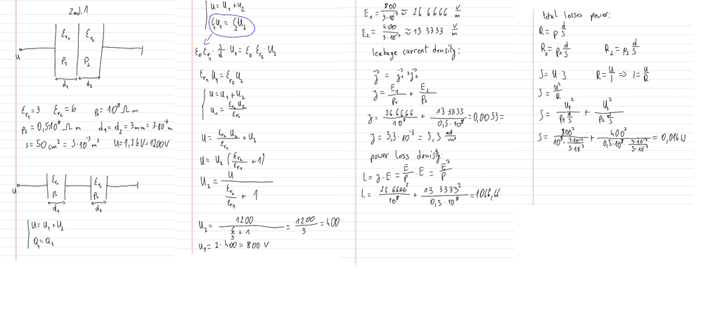

Determine the leakage current density, power loss density and total losses
power in a two-layer parallel plate capacitor.
εr1=3, εr2=6
ρ1=108Ωm, ρ2=0,5108Ωm,d1=d2= 3 mm
s=50 cm^2
U=1,2kV
Could somebody check my solution?
" ρ1=108Ωm, ρ2=0,5108Ωm,d1=d2= 3 mm"
Did you mean ρ1=108 Ωm, ρ2=0,5x108 Ωm? Then write that!
