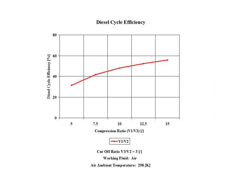

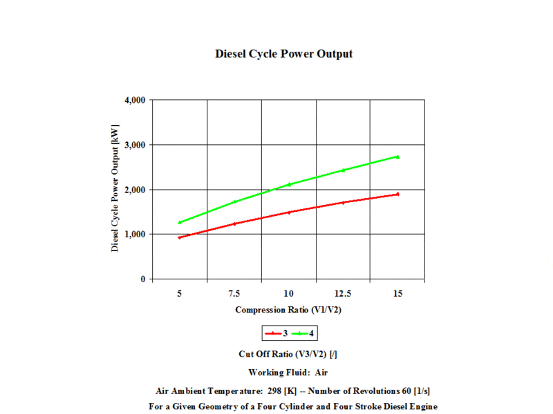

Hi there:
Here are two URLs on the Diesel Cycle operation.
Technical background information on Diesel Cycle
http://members.aol.com/engware/cycles.htm
Online calculator on Diesel Cycle operation
http://members.aol.com/engware/calc4.htm
The provided URLs should help you with Diesel Cycle technical background information and engineering calculations regarding the Diesel Cyucle operation and/or technical performance evaluation.
Here are two plots regarding the Diesel Cycle thermal efficiency and power output.
Thanks,
Gordan
