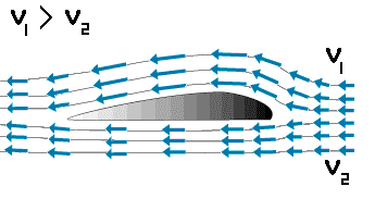

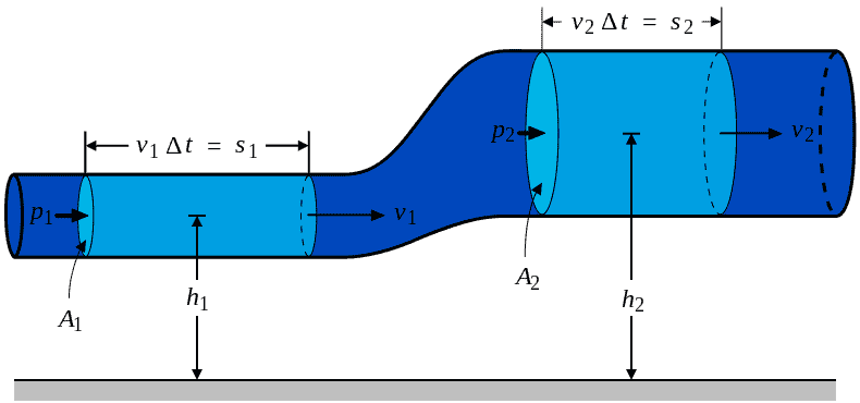

All flows are 3D, but some can be estimated to a 2D or even 1D flow to simplified the calculations without loosing to much accuracy.
For example, you can study an airplane wing section to evaluate its lifting potential in 2D (particles goes from front to rear and can also go up or down):
You can also study flow in a pipe in 1D situation (from inlet to outlet). In the above example, instead of considering the particles moving up and down when entering the enlarged pipe, we can just consider the area change:
