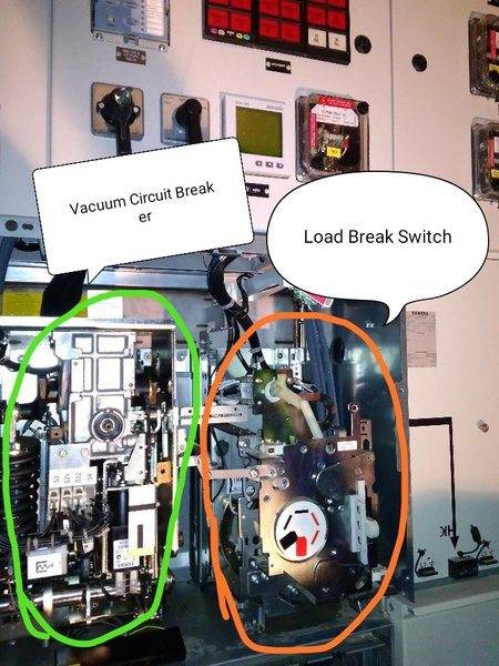

I am working in on a Ring Main Unit of Siemens make. Today, my senior asked me the same question. As per my understanding, a circuit breaker is make or break switch. I mean, when fault occurs the circuit breaker trips, protecting the equipment connected to the line.
I have no information or knowledge regarding "Load Break Switch (LBS)." This is regarding Ring Main Unit (RMU).
Please tell me the difference between the two with as much detailed explanation as you can.
Thank you.

Thank you for replying. Practically, I have observed few things. When the circuit breaker is ON, the load break switch can be turned ON or OFF but the Earth switch cannot be turned ON. Similarly, when Earth switch and breaker is ON, load break switch cannot be turned ON

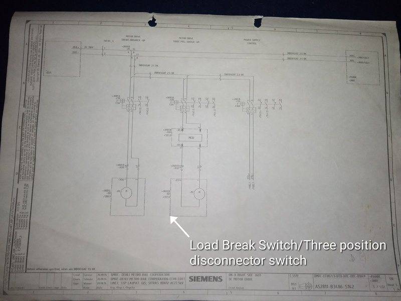

I would need to see a one line schematic diagram to be certain what you are talking about. Use the UPLOAD button to upload pictures to a post.
But once again, there are no language police. What one man calls a switch, another may call a breaker (perhaps incorrectly). So is your question about design, or about the meaning of words?

No. A one line schematic looks like this.

AN LBS is designed for interrupting the max rated load - and doing it multiple times... a CB is designed for interrupting the max Interrupting Current (IC) - that will be experienced in a fault, and this is often for a limited number of times.
Example - large switch max load 1200A - do not exceed this! But the Max IC rating for a 1200A CB ( Medium Voltage) may be 36,000A... The issues being faced are like night and day.
Consider a 15 A Light switch, in your house- it is fed by a 50,000 or 100,000 A interrupting breaker - bot also rated at 15A.
