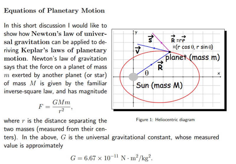

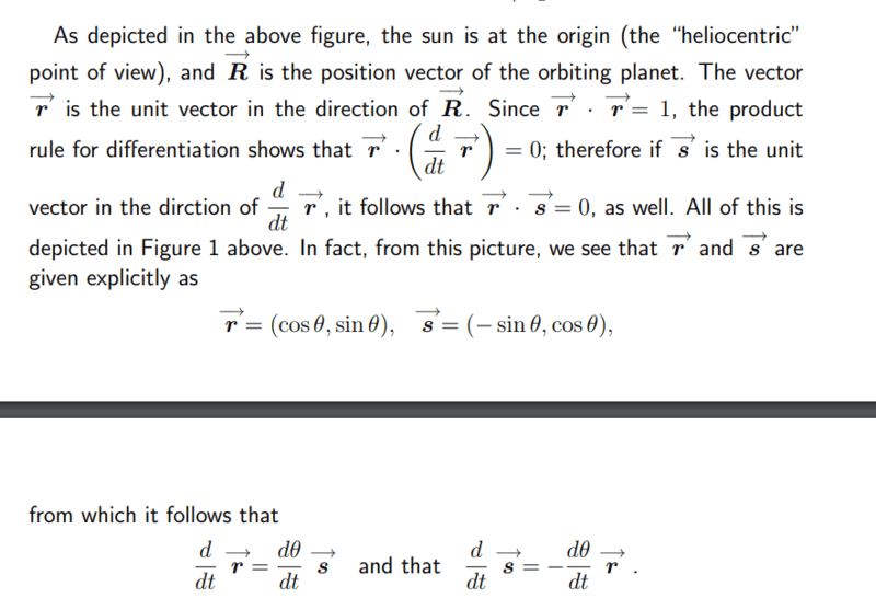

In a physics pdf about kepler laws of motion I found these things. I also solo-learned calculus recently so I am not used to notations.
So, first of all, why and how are we taking the derivative of the vector r or s as d/dt if t is not a parameter of the equations?
Second question is what is the difference between d/dt(r) and d(theta)/dt(r) and also between d/dt(s) and d(theta)/dt(s)? Like, both of these appear at the bottom of the second image (and further in the pdf) and I don't see a difference.
P.S.:I attached the whole file to this post just in case.
Edit: Also, why is the orbit described as R=(r*sin(theta);r*cos(theta))? Isn't that a circle? Shouldn't it be considered an ellipse, parabola or hyperbola or anything else? What I mean is that there is drawn an ellipse but the vector form describes a circle. Why?
The planets are moving, i.e. they change position in time ##t##. Therefore ##r\, , \,s,## and ##\theta## change in time, i.e. are functions dependent on time. It is implicitly assumed without noting ##\vec{r}=\vec{r(t)}\, , \,\vec{s}=\vec{s(t)},## and ##\theta=\theta(t).##
## \dfrac{d}{dt} f(t) = \dfrac{df(t)}{dt} = f'(t) =\dot{f}(t) ## are all different notations of the derivative of the function ## f=f(t) ## with respect to the variable ##t## that is usually used for time.
Here are even more notations:
https://www.physicsforums.com/insights/the-pantheon-of-derivatives-i/
It is only a circle if the radius ##r## does not change in time.
It describes an ellipse if the radius ##r## changes.
Likes dextercioby and Anonymous001

Thanks a lot, it really helped. I would have one more question as I went further into the proof. If ##r## changes in time, why does it say that we use a notation ##L=r^2*\frac{d\theta}{dt}## and ##L## is constant? Why is it constant if ##r## changes in time?
##L## does not only depend on ##r.## It also depends on ##\theta .## The combination is constant. It goes like this:
The velocity of the planet is a vector. In our case, a vector in the plane where the planet orbits the sun. It means: two-dimensional. The vectors ##\vec{r}## and ## \vec{s}## build a coordinate system of this plane. We can therefore express the vector ##\vec{v}## by its components, its parts of the vectors ##\vec{r}\, , \,\vec{s}.## The equation is
\begin{align*}
\vec{v}=\dfrac{dr}{dt} \cdot \vec{r} +r\cdot \dfrac{d\theta}{dt} \cdot \vec{s}\tag{2}
\end{align*}
Now, the change of velocity per time is acceleration. This yields (see the calculation in your .pdf)
\begin{align*}
\vec{a}=\underbrace{\left(\dfrac{d^2r}{dt^2}-r\cdot \left(\dfrac{d\theta}{dt}\right)^2\right)}_{=a_1(t)}\cdot \vec{r} +\underbrace{\left(2\cdot \dfrac{d\theta}{dt}\cdot\dfrac{dr}{dt}+r\cdot\dfrac{d^2\theta}{dt^2}\right)}_{=a_2(t)}\cdot \vec{s}\tag{*}
\end{align*}
where ##\dfrac{d^2r}{d^t}=\ddot{r}(t)## and ##\dfrac{d^2\theta}{dt^2}=\ddot{\theta}(t)## are the second derivatives with respect to time.
Next, we look at Newton's law of gravity, where ##G## is the gravitational constant and ##M## the mass of the sun, ##m## the mass of the Earth, and ##\vec{r}## the coordinate direction of the force.
F=-\dfrac{G\cdot M\cdot m}{r^2} \cdot \vec{r}
and his second law of motion, which states that a force is determined by
F=m\cdot \vec{a}
These two equations give us (##m## cancels)
\begin{align*}
-\dfrac{G\cdot M}{r^2}\cdot\vec{r}=\vec{a}
\end{align*}
This means we have two different ways to describe the acceleration
\vec{a}=\left(-\dfrac{G\cdot M}{r^2}\right)\cdot \vec{r}+ 0\cdot \vec{s} =a_1(t)\cdot \vec{r}+a_2(t)\cdot \vec{s}
However, the two directions ##\vec{r}## and ##\vec{s}## form a coordinate system of the plane of motion, the orbital plane. This means we can directly compare their components:
\vec{a}=\underbrace{\left(-\dfrac{G\cdot M}{r^2}\right)}_{=a_1(t)}\cdot \vec{r}+ \underbrace{0}_{=a_2(t)}\cdot \vec{s}
We thus have the two equations
\begin{align*}
-\dfrac{G\cdot M}{r^2}&=a_1(t)=\dfrac{d^2r}{dt^2}-r\cdot \left(\dfrac{d\theta}{dt}\right)^2\tag{3}\\
0&=a_2(t)=2\cdot \dfrac{d\theta}{dt}\cdot\dfrac{dr}{dt}+r\cdot\dfrac{d^2\theta}{dt^2}\tag{4}
\end{align*}
Finally, just for fun, let us differentiate ##r^2\cdot\dfrac{d\theta}{dt}.## This yields by the product (Leibniz) and chain rule
\begin{align*}
\dfrac{d}{dt}\left(r^2\cdot\dfrac{d\theta}{dt}\right)&=\dfrac{d}{dt}(r^2(t))\cdot \dfrac{d\theta}{dt} +r^2(t)\cdot\dfrac{d}{dt}\left(\dfrac{d\theta}{dt}\right)\\
&=2\cdot r(t)\cdot \dfrac{d}{dt}r(t)\cdot\dfrac{d\theta}{dt}+r^2(t)\cdot\dfrac{d^2\theta}{dt^2}\\
&=r(t)\cdot \left(2\cdot \dfrac{d}{dt}r(t)\cdot\dfrac{d\theta}{dt}+r(t)\cdot\dfrac{d^2\theta}{dt^2}\right)\\
&=r(t)\cdot a_2(t) = r(t)\cdot 0 = 0
\end{align*}
This means that ##L:=r^2(t)\cdot\dfrac{d\theta}{dt}## has a zero derivative, i.e. is constant in time. Neither the radius nor the angle is, but ##L## is. Only constant functions have zero derivatives.
Likes Anonymous001 and dextercioby
