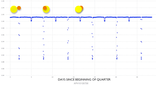

Why? With planets you only get dips in the curve when the planet transits the star, not the other way around. With binaries you get dips in both cases.
Like so:
(image source: planethunters.org)
Like so:
Ok, now it is clear to me. Thanks.
I think there is some confusion here. It's not that Kepler can't tell eclipsing binaries from exoplanets. They are easy to tell apart, as Bandernsatch illustrates. The problem comes when you are monitoring the brightness of a star, and there is another (fainter) eclipsing binary star coincident with the star you are measuring. Kepler intentionally defocuses images in order to reduce the error of a brightness measurement by spreading the light of the star across several pixels. This means that what looks like one star can actually contain the star you are interested in and also contain a dimmer eclipsing binary that you don't know is there. When the light from the eclipsing binary dips, you see a very small dip in the star you are monitoring that can look just like the signal of an exoplanet. The secondary dip can be so small that you don't see it. This is one of the main reasons why Kepler candidates are considered "candidates" until the same star has been followed up with a larger telescope at higher resolution to make sure there is no contamination.

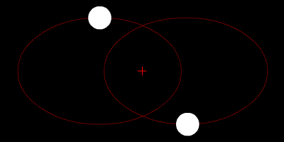

Suppose we have this:
If we are looking from the bottom center straight up we could see an eclipse followed by a second eclipse with 1 second spacing. The next eclipse is 5 seconds later. If we observe from side-center we would have 3 seconds between each eclipse.
If we are talking about the length of the eclipse itself we get the same length only when looking vertically (vertical on upright computer screen). In the horizontal few there is a quick eclipse at periapsis followed by a long duration eclipse at apoapsis.
Looking at more angles you get various lengths but only 2 are equal.
Again, as I wrote earlier - I don't mean spacing between dips made by one star transiting and then the other. I mean that spacing between two transits of one star is the same as the spacing between two transits of the other star (6 seconds in your example). That's what shows that they're both sharing the orbital period, and what differentiates the dips from two planets on different orbits transiting the star.
