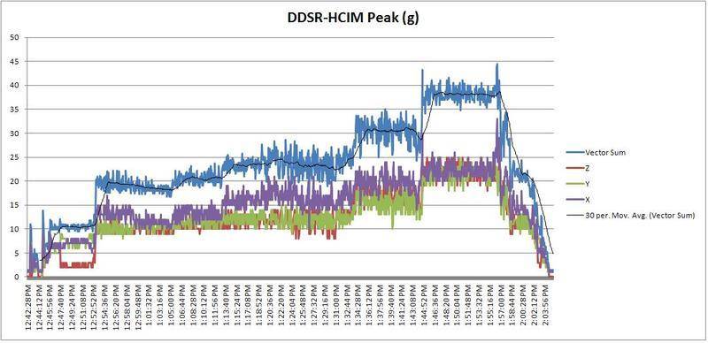

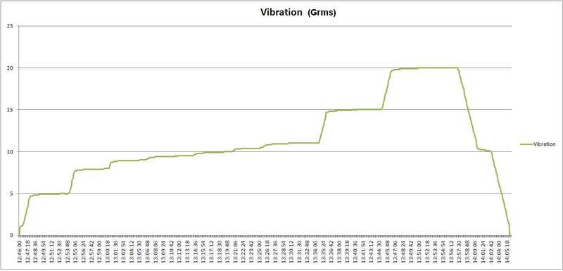

I am currently doing a vibration analysis using a random vibration machine which gives Grms value based on Power Spectral Density (PSD) plot using Fast Fourier transform(FFT).
Before I ran the test on my specimen, I tried to characterise the vibration using a DDSR board (accelerometer). Interestingly, the G-force recorded from the accelerometer far exceeds the values I've set on the random vibration machine.

Yes the accelerometer is of a larger value as I'm referring to the peak values and Grms is derived from the integral of the PSD plot.
But how do i convert the g-force values of the accelerometer such that i can compare it with the Grms value the vibration machine gives? (both the accelerometer and vibration machines are done over the same time interval)
I've attached the plotted graphs, The shape of the graphs coincides, however the magnitude differs quite significantly. How would you suggest to reconcile both graphs?

I'm comparing because I want to ensure that the level of excitation at the component on the test specimen is really experiencing the desired magnitude of vibration that I've set on the vibration machine. (unique because the specimen is placed in a non-conventional orientation)
--The excitation peaks are the same, but the magnitude is not.--
For example, look at the highest peak which is at 20Grms , but on the accelerometer graph it gives approx. 38G. That doesn't seem to agree with each other. After I've done an RMS calculation, I still got 38. ( But that is probably because the G -values on the accelerometer are the peak values??)cheers
I notice the magnitude is close for a single axis rather than the vector sum of the 3; is it possible the Grms value is along a single axis (say the X axis)?
Also, how is the table measuring the Grms value? Where is its accelerometer? Ideally if you want the numbers to match you want the two accelerometers close together...

Your first statement gave me clues. I went to look at the drawings for the vibration machine and it has only ONE accelerometer measuring a single axis. It is placed close to the specimen.
However, upon reading some literature (attached file), the Grms and G-force values are correlated by a amplification factor blah blah... but i cannot place a accelerometer measuring g-force into random vibration machine to expect it to coincide with each other.
Nevertheless, after applying a correlation formula, the correlation is sufficiently consistent and close! I guess this is where this thread ends! Thanks.
