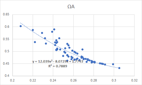

For reference, these are my results for A vs. a parameter where the values for A are generalized via the parameter:
This one's from SSE
And this one's from MAPE

They're supposed to be different.
It's like this, I fit A, B, C, and D on a Y, Z vs. X equation. Then I get different values of A, B, C, and D for each set of Y, Z vs. X.
Then if I generalize A, B, C, and D by plotting it against a certain parameter (which is known to our field to work), those graphs appear. MAPE shows a generalization of A better than SSE.
So this is a more complicated scenario that simply fitting one curve to one set of data. However, we should start with looking at how the curve fits for individual sets of Y,Z vs X data look.
It's not clear what you mean by "generalizing A". Are you saying that you have a theoretical equation that predicts "A" as a function of the "certain parameter"? Does each set of Y,Z vs X data correspond to a single valule of that certain parameter?

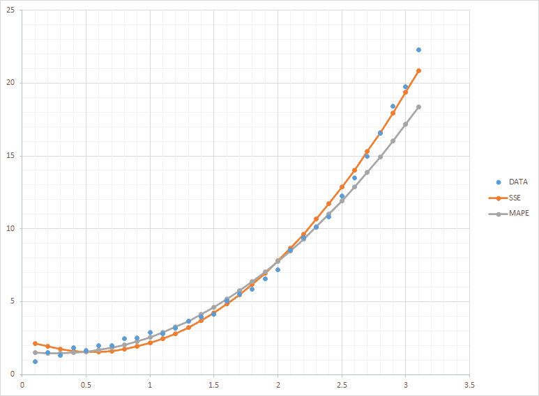

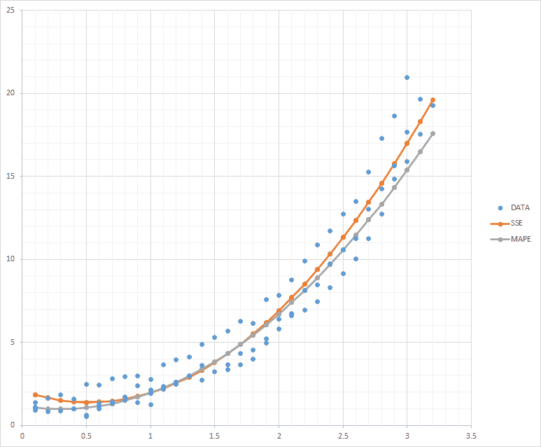

Hi. I was able to replicate my problem in a more simple manner. I hope this would bring in more insight.
So what I did was generate data from y = exp(x) + rand(). Then I tried fitting a quadratic function on the dataset twice, the first one (orange) using the SSE formulation (minimizing the sum of the squares of the residuals) and the second one using the MAPE formulation (minimizing the average absolute percentage error). The results are as follows:
This is what I 'mean' before. Why is it that the MAPE and SSE curves (in turn, the coefficients of the fitting quadratic polynomial) not the same? While I know the objective functions are obviously not the same, what are the differences between MAPE and SSE in handling errors such that it ended up this way?
For my study, MAPE seems to work better - and it was the one being used by almost all researches in my field, but IMO it's so brain-dead to use something because everyone is using it and that no one knows the concept behind it. I still cannot differentiate why does it work better compared to SSE. That's why I was asking how SSE or MAPE handles errors. Like, does the coefficient n in MAPE have any bearing? Or something?
EDIT: Updating the spreadsheet file to include the following:
So I tested what if I only had a single measurement for a certain point, and now MAPE works better. SSE works better at the larger x-values though:
May I know why is this happening?
I can't understand why you would expect the fits to be the same curve. If there happened to be one curve that produced zero error at all points then I can understand why MAPE and SSE would both result in that curve. Otherwise, why should they produce the same result?
Let's take a simple case. Suppose there are 2 data points, ## y = 10, y = 100## and you want to find a single number to approximate those two values.
The value ##a## that minimizes the MSE = ##(1/2)( (a-10)^2 + (a-100)^2) ## is ##a = (10 + 100)/2 = 55##.
The value ##a## minimizes MAPE = ## (1/2)( |a-10|/10 + | a-100|/100) ## is ##a = 10##
In manner of speaking, minimizing MAPE doesn't consider the error between 100 and ##a=10## to be large, but SSE does.
