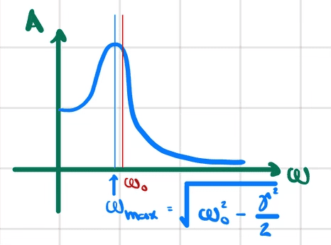

If ##\omega_0## is given (by the nature of the physical system under consideration, for example the spring constant and mass of a simple pendulum) then ##A## can be thought of as a function of the driving angular frequency ##\omega_d##.
We can differentiate (1) and find the ##\omega_d## that maximizes amplitude.
We find
##\omega_{d,max}=\sqrt{\omega_0^2-\frac{\gamma^2}{2}}\tag{3}##
Pictorially

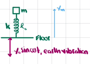

As a concrete example, consider a seismograph.
The floor (the Earth) vibrates at a certain angular frequency that we can measure but not control. This drives the mass on the spring.
We want to choose ##\omega_0## such that the amplitude of the mass is the largest.
