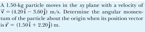

I am interested to understand how to tell when to use the scalar or cross product when solving physics problems.
Instantaneous angular momentum = cross product of the instantaneous position vector and instantaneous momentum
Hi!
For example, how do you tell whether to use the scalar or cross product for an problem such as,
However, I do know that instantaneous angular momentum = cross product of the instantaneous position vector and instantaneous momentum. However, what about if I didn't know whether I'm meant to take the cross product or scalar product of the quanties given. For example, for this work problem,
How would I tell whether to use the scalar or dot product just by looking at the work equation,
Many thanks!

The equation you posted shows ##\cdot##, the dot (or 'scalar') product operator. If it were the cross (or 'vector') product it would show ##\times## as the operator.

The work equation is defined using the dot product, just as angular momentum is defined with a cross product.
